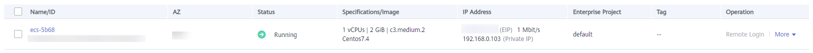

- Log in to the management console and check whether there is an ECS available.
Figure 1 ECS
- Buy an ECS and select Linux (for example, CentOS) as its OS.

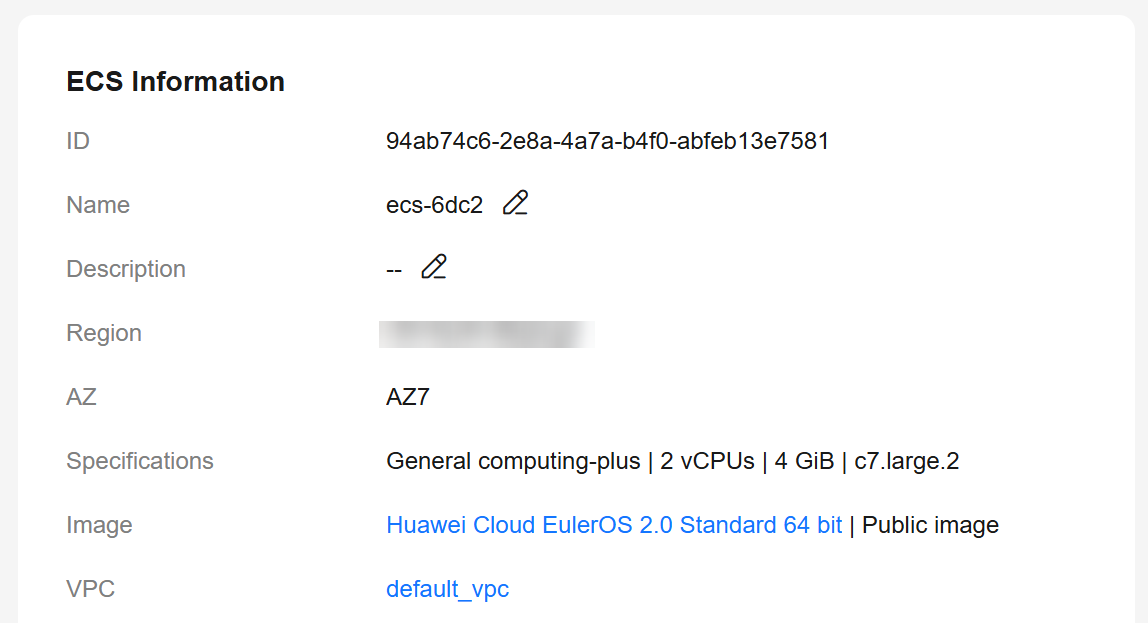

- On the ECS Information page, view the region and VPC of the ECS.
Figure 2 ECS information

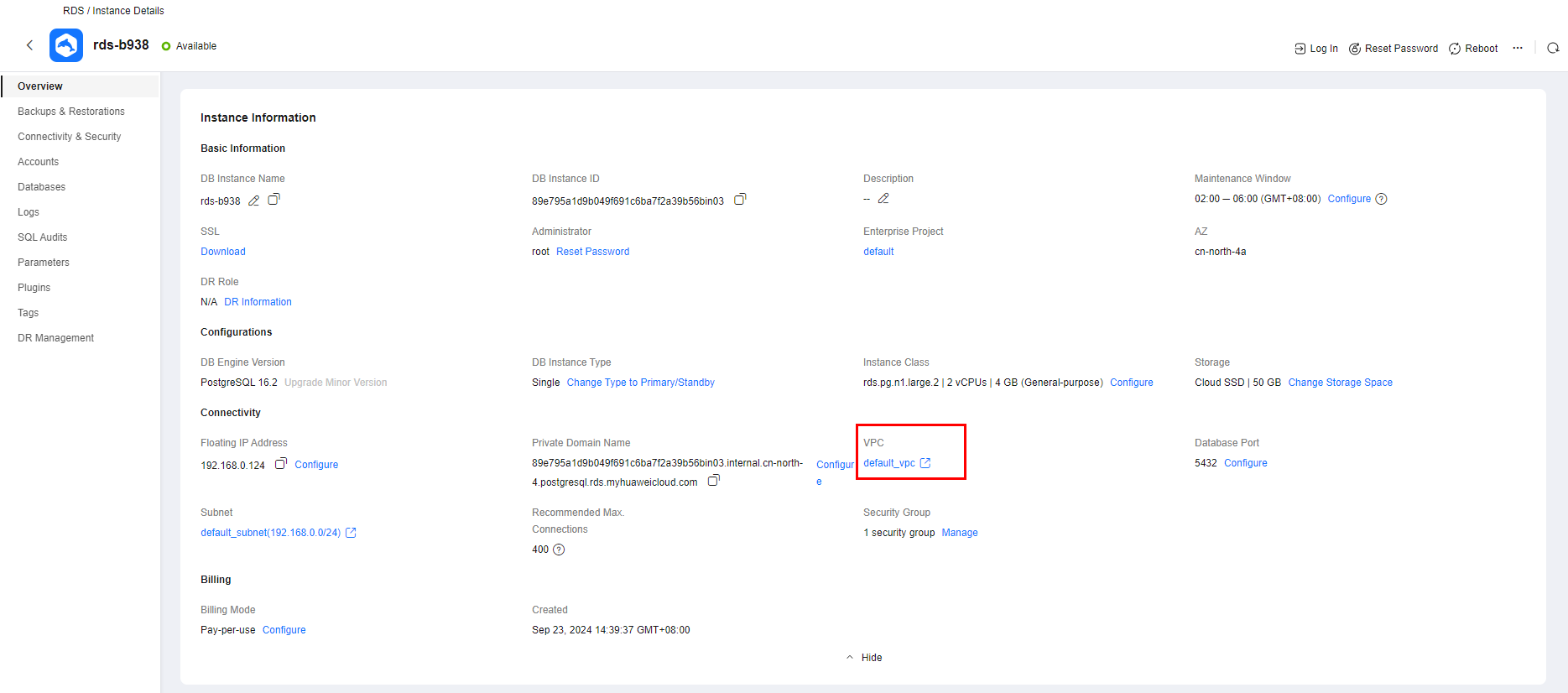

- On the Summary page of the RDS for PostgreSQL instance, view the region and VPC of the DB instance.
Figure 3 Overview
- Check whether the ECS and RDS for PostgreSQL instance are in the same region and VPC.
- If yes, go to Installing a PostgreSQL Client (PostgreSQL 15 and Earlier).
- If they are not in the same region, purchase another ECS or DB instance. The ECS and DB instance in different regions cannot communicate with each other. To reduce network latency, deploy your DB instance in the region nearest to your workloads.
- If the ECS and DB instance are in different VPCs, change the VPC of the ECS to that of the DB instance. For details, see Changing a VPC.

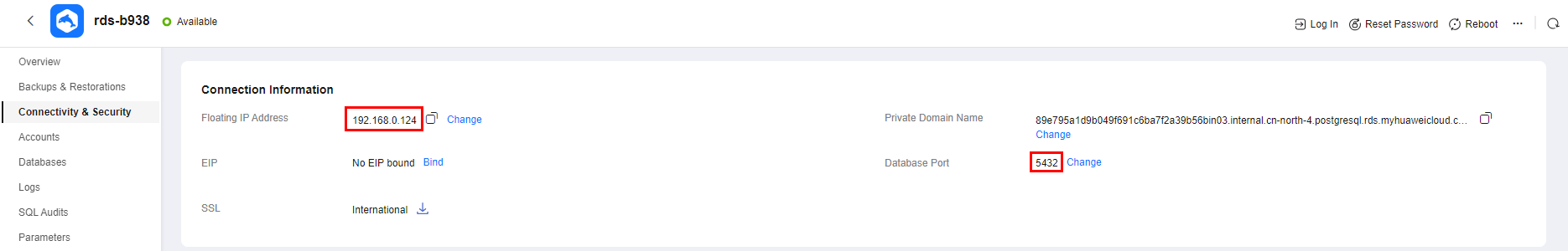

- On the Instances page of the RDS console, click the DB instance name.
- Choose Connectivity & Security from the navigation pane. In the Connection Information area, obtain the floating IP address and database port of the DB instance.
Figure 4 Connection information

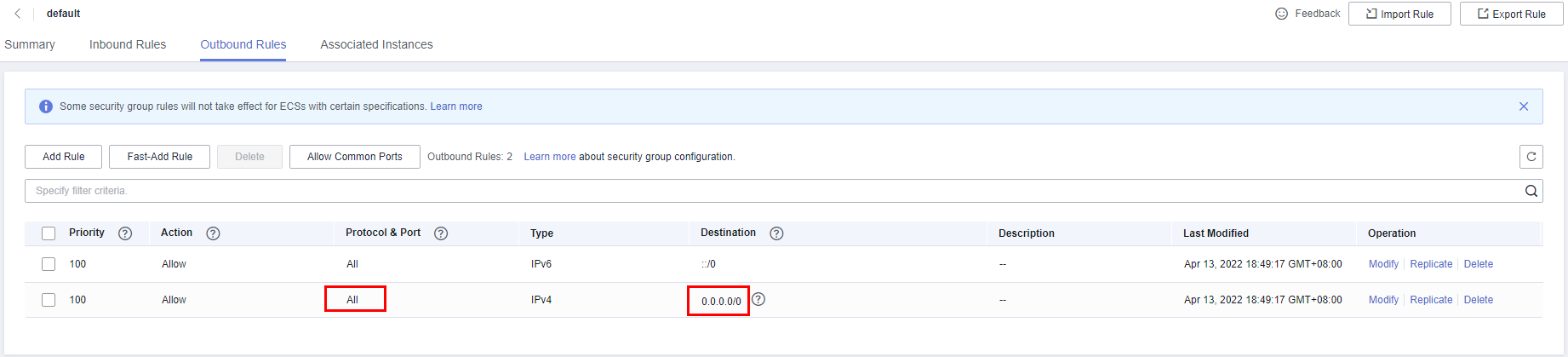

- If no, check the security group rules.
- If in the security group of the ECS, there is no outbound rule with Destination set to 0.0.0.0/0 and Protocol & Port set to All, add an outbound rule for the floating IP address and port of the DB instance.

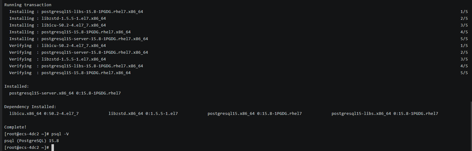

Run the installation commands:
sudo yum install -y https://download.postgresql.org/pub/repos/yum/reporpms/EL-7-x86_64/pgdg-redhat-repo-latest.noarch.rpm sudo yum install -y postgresql15-server
Check whether the installation is successful.
psql -V
Figure 7 Successful installation

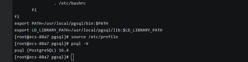

- Add the following code to the /etc/profile file to configure environment variables:
export PATH=/usr/local/pgsql/bin:$PATH export LD_LIBRARY_PATH=/usr/local/pgsql/lib:$LD_LIBRARY_PATH source /etc/profile
- Test whether the psql is available.
psql -V
Figure 12 Testing psql
