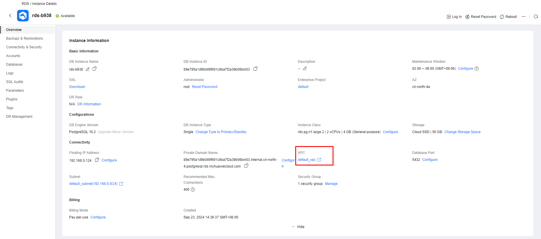

  5. Click the target RDS for PostgreSQL instance name. On the Summary page, find its region and VPC.
    Figure 3 RDS for PostgreSQL instance details

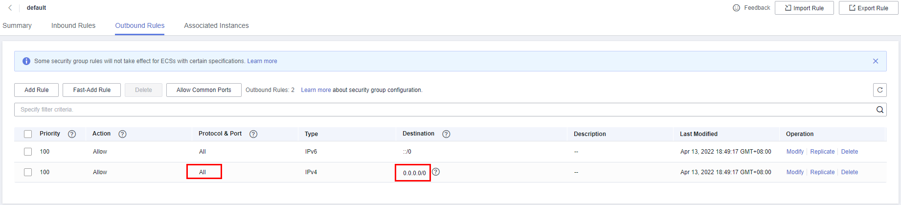

      • If in the security group of the ECS, there is no outbound rule with Destination set to 0.0.0.0/0 and Protocol & Port set to All, add an outbound rule for the EIP and port of the DB instance.
        Figure 4 ECS security group

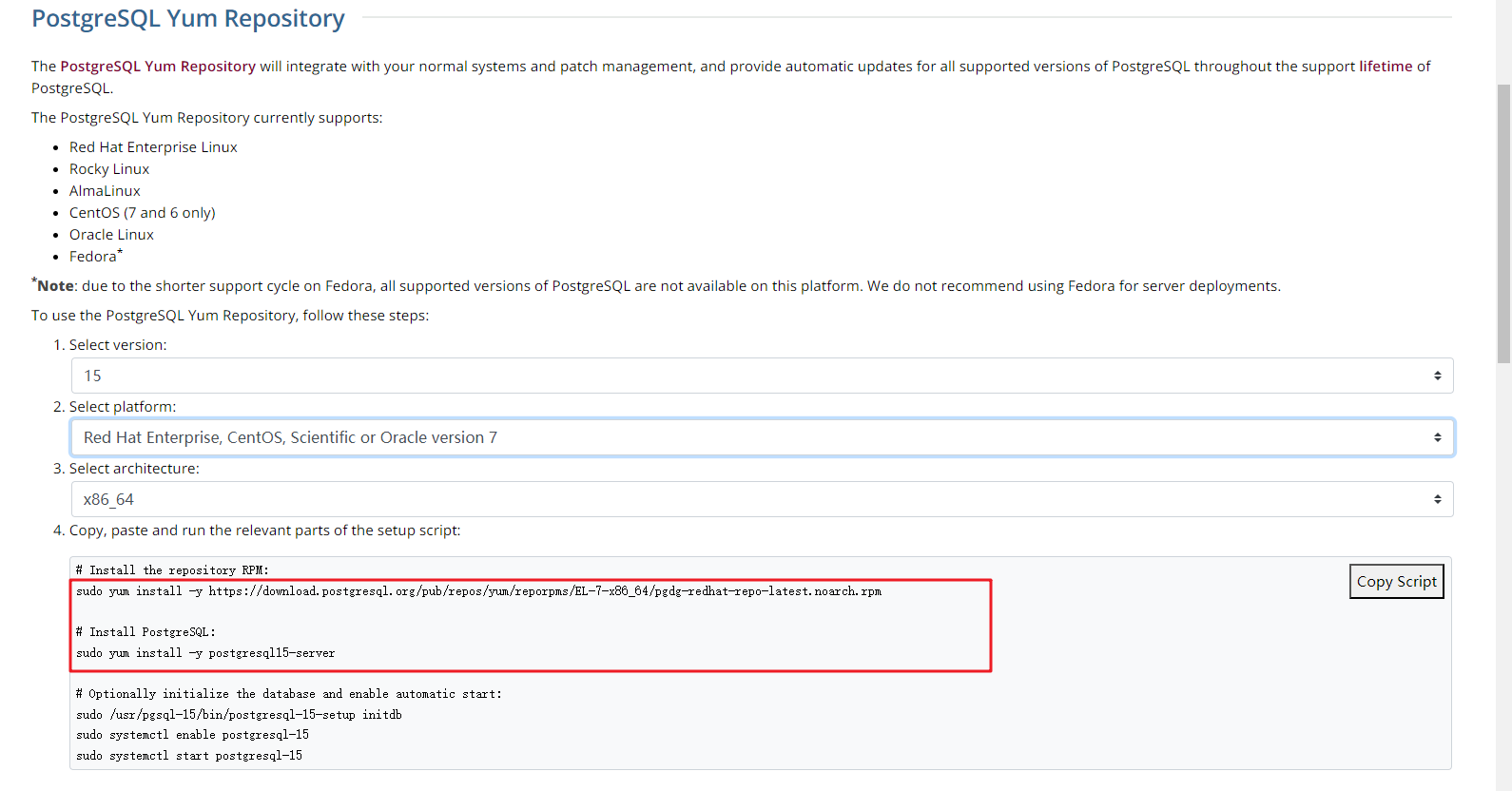

    The PostgreSQL community provides client installation methods for different OSs. You can download and install a client using the installation tool of the OS. This installation method is simple but has requirements on the ECS OS. Only the OSs supported by the PostgreSQL community can use this installation method.
    In this example, CentOS 7 is used. Use the default installation tool of the OS to install a client (PostgreSQL 15 or earlier).
    Figure 5 Obtaining the installation tool

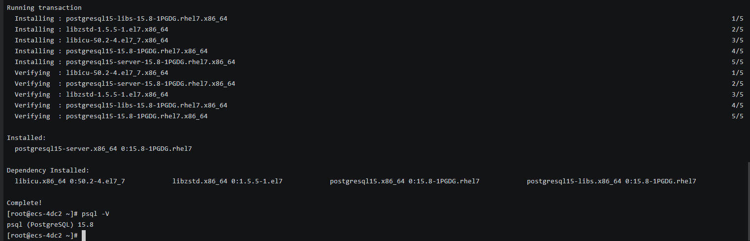

    Check whether the installation is successful.
    psql -V
    Figure 6 Successful installation

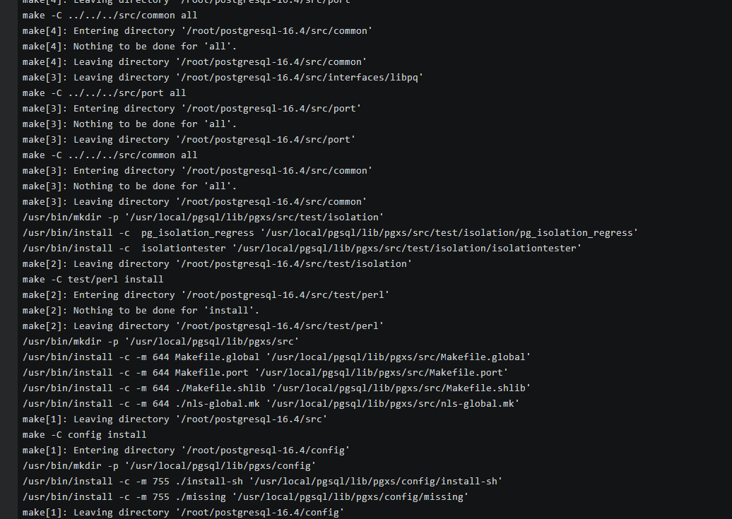

    4. Compile the source code and install the client.
      cd postgresql-16.4
      ./configure --without-icu --without-readline --without-zlib --with-openssl
      make -j 8 && make install
      If --prefix is not specified, the default path is /usr/local/pgsql. The client can be installed in the simplest way.
      Figure 9 Compilation and installation

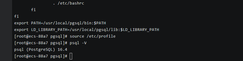

    5. Add the following code to the /etc/profile file to configure environment variables:
      export PATH=/usr/local/pgsql/bin:$PATH
      export LD_LIBRARY_PATH=/usr/local/pgsql/lib:$LD_LIBRARY_PATH
      source /etc/profile
    6. Test whether the psql is available.
      psql -V
      Figure 10 Testing psql
