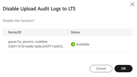

Disabling Upload Audit Logs to LTS
 - Click
 in the upper left corner and select a region and project. - Click
 in the upper left corner of the page and choose . - In the navigation pane on the left, choose Instances.
 - Click the instance name to go to the Basic Information page.
 - In the navigation pane on the left, click Audit Logs.
 - Click
 next to Upload Audit Logs to LTS. - In the displayed dialog box, confirm the information.
     Figure 2 Disabling Upload Audit Logs to LTS
      - In the displayed dialog box, click OK.
