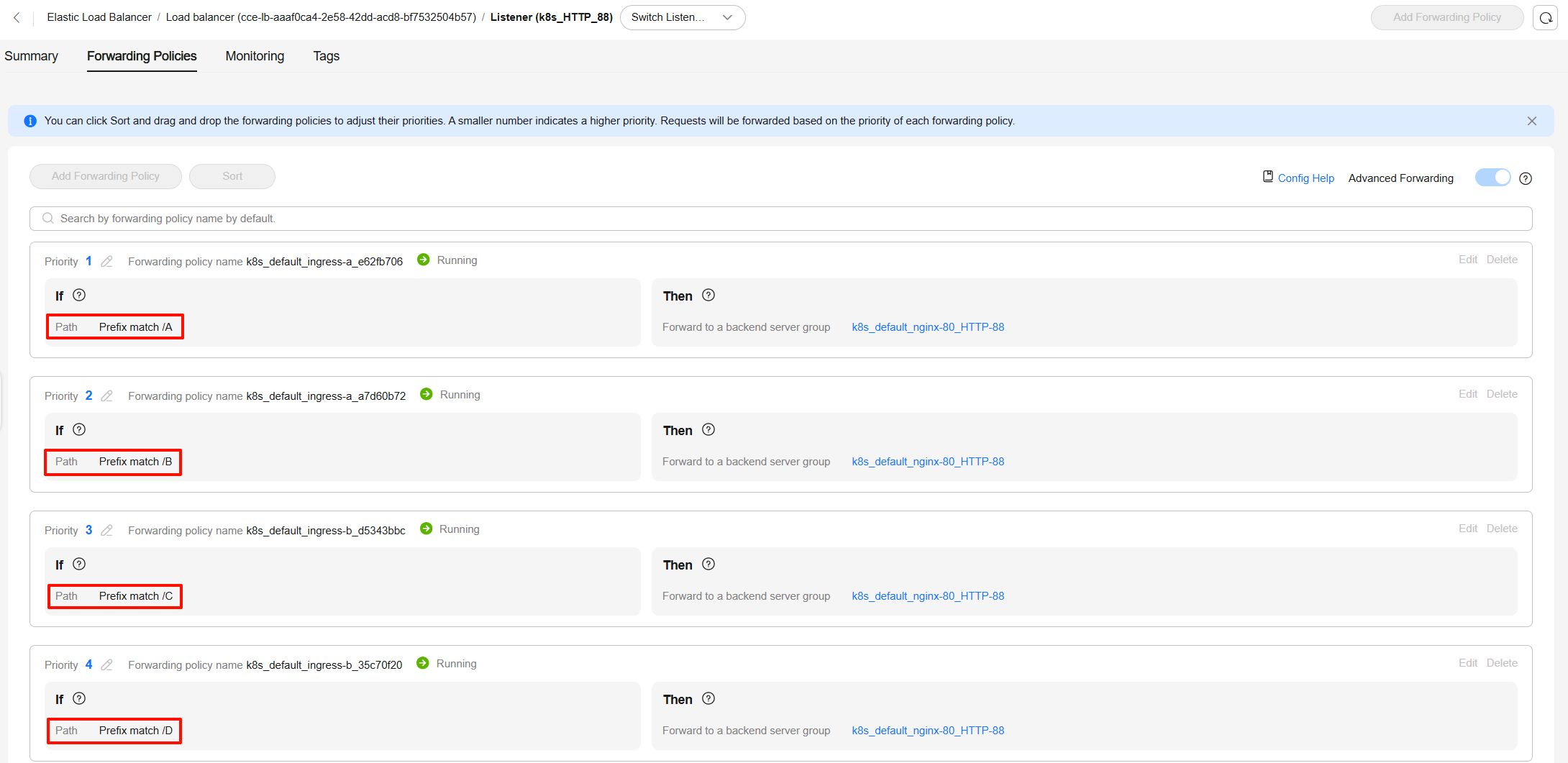

Examples for Setting the Priorities of Forwarding Rules
Assume the following configurations: The kubernetes.io/elb.ingress-order value of ingress A (ingress-a) is set to 1, and this ingress has forwarding rules A and B. The kubernetes.io/elb.ingress-order value of ingress B (ingress-b) is set to 2, and this ingress has forwarding rules C and D.
The following table lists the sorting order of the load balancer's forwarding policies when ingresses A and B access the same load balancer port.
Priority |
Forwarding Rule |
Ingress |
1 |
A |
ingress-a |
2 |
B |
ingress-a |
3 |
C |
ingress-b |
4 |
D |
ingress-b |

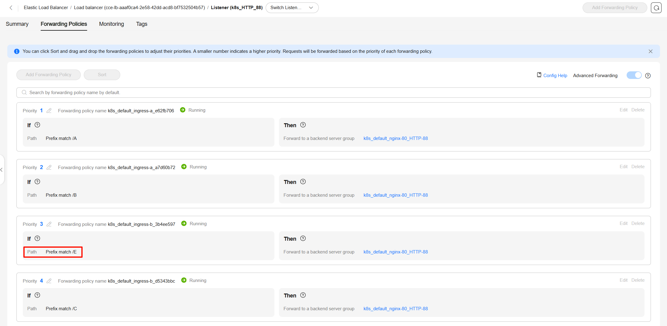

If you add rule E to ingress-b and list the rule ahead of rules C and D, modify the YAML configuration for ingress-b as follows:
apiVersion: networking.k8s.io/v1
kind: Ingress
metadata:
namespace: default
annotations:
kubernetes.io/elb.port: '88' # The port on the interconnected load balancer
kubernetes.io/elb.id: f7fb2aa8-34af-48fb-b451-16e8f675ff45 # The ID of the existing load balancer
kubernetes.io/elb.class: performance # The type of the existing load balancer, which can only be performance
kubernetes.io/elb.ingress-order: '2' # The priority of forwarding rules across different ingresses
kubernetes.io/elb.rule-priority-enabled: 'true' # The forwarding rules of an ingress are prioritized based on the forwarding rule sequence in paths.
spec:
rules:
- host: ''
http:
paths:
- path: /E # Define forwarding rule E.
backend: # The backend Service associated with the rule. The value provided is only an example and can be modified as needed.
service:
port:
number: 80
property:
ingress.beta.kubernetes.io/url-match-mode: STARTS_WITH
pathType: ImplementationSpecific
- path: /C # Define forwarding rule C.
service:
port:
number: 80
property:
- path: /D # Define forwarding rule D.
service:
port:
number: 80
property:
ingressClassName: cce
The following table lists the sorting order of the load balancer's forwarding rules.
Priority |
Forwarding Rule |
Ingress |
1 |
A |
ingress-a |
2 |
B |
ingress-a |
3 |
E |
ingress-b |
4 |
C |
ingress-b |
5 |
D |
ingress-b |
