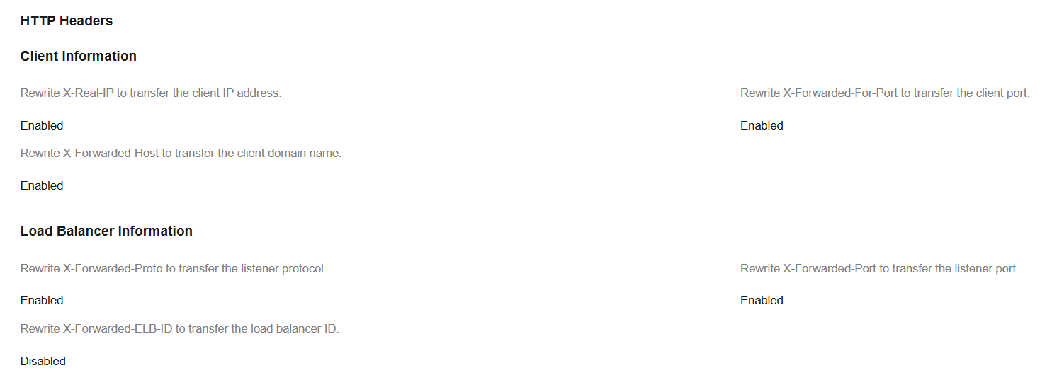

Verifying Configuration
- Log in to the CCE console and click the cluster name to access the cluster console.
- In the navigation pane, choose Services & Ingresses. Locate the row that contains the created Service and click the load balancer name to go to the ELB console.
- Switch to the Listeners tab, click the listener name of the created port, and check whether options are enabled.
