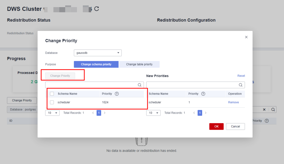

Before redistribution starts or when redistribution is paused, you can set redistribution priorities for the tables that have not been redistributed by schema or table.

- When redistribution is paused, you can set the redistribution priority (in schema or table dimension), and redistribution will be performed based on the configured redistribution sequence. You can also set the redistribution priority before the redistribution starts. Figure 1 Redistribution priority

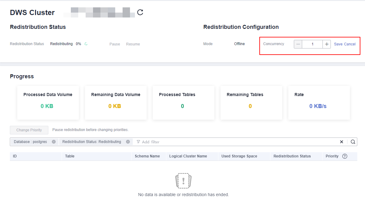

- The number of concurrent redistribution tasks can be adjusted during redistribution. Clusters running version 8.1.0 or earlier do not support dynamic adjustment. To change the redistribution concurrency, suspend the redistribution first. Figure 2 Redistribution concurrency
