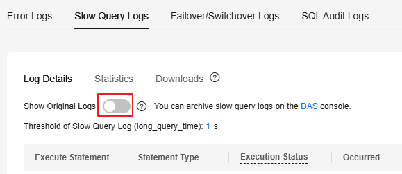

- On the Log Details tab page, turn on the toggle switch
next to Show Original Logs.
Figure 1 Turning on Show Original Logs

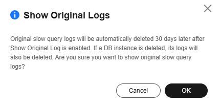

- In the displayed dialog box, click OK.
Figure 2 Submitting the request

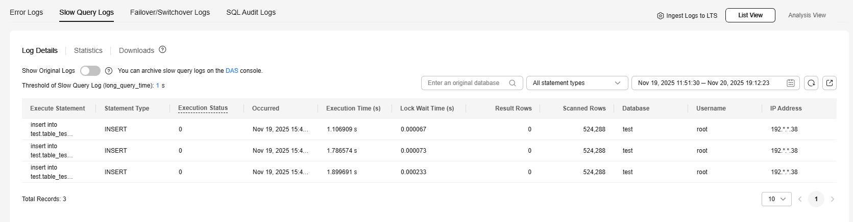

- On the Log Details tab page, view the slow query log details.
Figure 3 Slow query log details

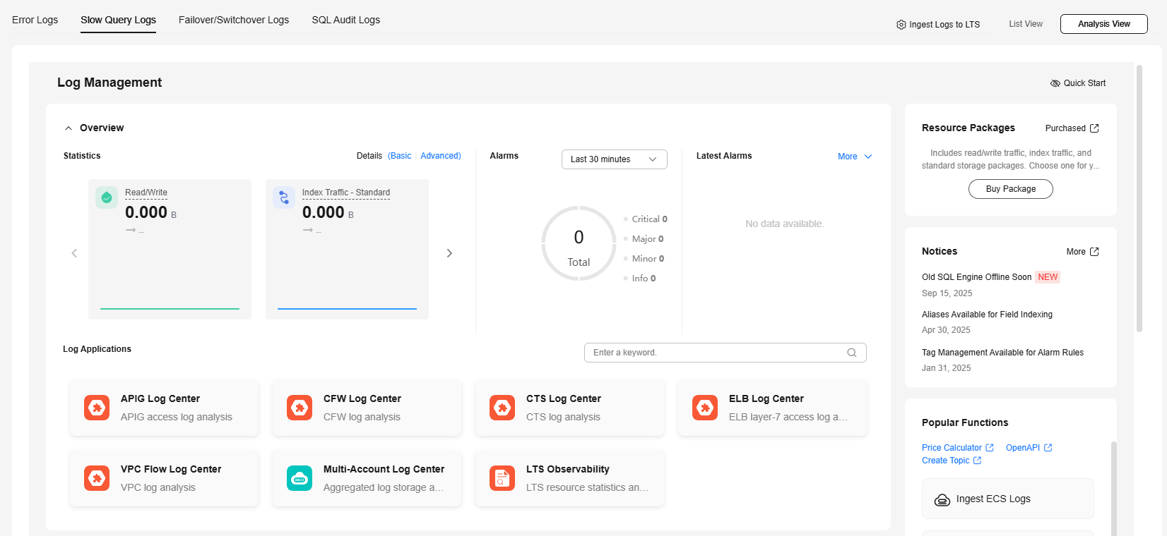

If Slow Log Ingestion to LTS is enabled, you can switch to the analysis view in the upper right corner of the page to see more details. For more information, see Managing Log Groups.Figure 4 Analysis view
- You can view the slow query log records of a specified statement or a specific time period.
- The Scanned Rows column indicates the number of data rows that are actually accessed and processed during SQL execution.
- Only SELECT statements return the number of result rows (column Result Rows). The number of result rows for the INSERT, UPDATE, DELETE, and CREATE statements is 0 by default.
- You can view slow query logs of a specified database name (which cannot contain any special characters). The database name supports only exact search.
- Slow query logs record executed statements whose execution duration exceeds the threshold.
- The long_query_time parameter determines when a slow query log is recorded. Changes to this parameter do not affect already recorded logs. For example, if the value of this parameter is changed from 1 to 0.1 (unit: second), RDS starts recording statements that meet the new threshold and still displays the previously recorded logs that do not meet the new threshold.
- A maximum of 2,000 slow log records can be queried. To view more slow query log records, submit a service ticket.
- To export log details, submit a service ticket. You can export them by time range. A maximum of 1,000 records can be exported at a time.
- If the length of a single line of an SQL statement exceeds 10 KB or the statement has more than 200 lines, the SQL statement will be truncated. When you view slow query log details, SQL statements may be incomplete after special processing and are for reference only.

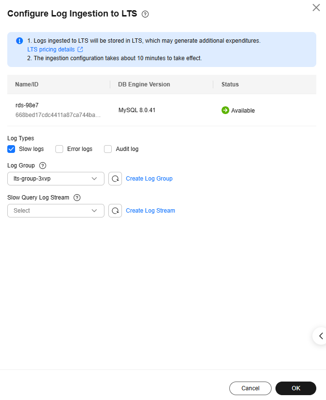

- Click Ingest Logs to LTS in the upper right corner of the page.
- In the displayed dialog box, select Slow logs under Log Types, select a log group and log stream, and click OK.
Figure 12 Configuring slow log ingestion to LTS
