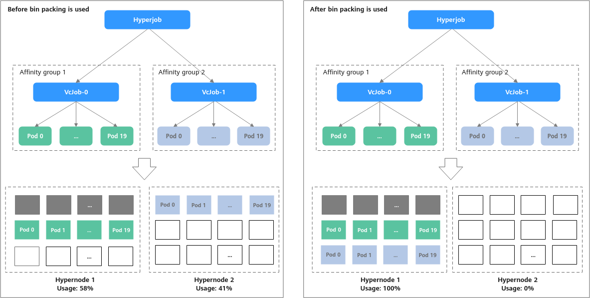

  • Bin packing: When hypernodes are on an equivalent network, Volcano Scheduler preferentially allocates hyperjobs to a hypernode with the fewest resource fragments to improve resource utilization. In Figure 2, there are two hypernodes (hypernode 1 and hypernode 2) in the cluster, and eight nodes on hypernode 1 have been allocated for executing other jobs. A hyperjob that contains two Volcano jobs is delivered. Each Volcano job requires 20 pods, and each pod requests to exclusively occupy a node.
    • If bin packing is not used, VcJob-0 may be scheduled to hypernode 1 and vcjob-1 to hypernode 2. In this case, the usage of hypernode 1 is 58% (28/48 × 100% = 58%), and that of hypernode 2 is 41% (20/48 × 100% = 41%).
    • If bin packing is used, vcjob-0 and vcjob-1 are preferentially scheduled to hypernode 1, and its usage is 100%. The usage of hypernode 2 is 0%, so that hypernode 2 is idle and can be used to handle other jobs.
      Figure 2 Hypernode usages before and after bin packing

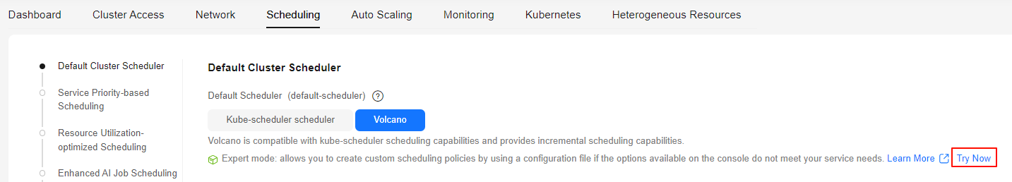

  1. Log in to the CCE console and click the cluster name to access the cluster console. In the navigation pane, choose Overview. In the navigation pane, choose Settings. Then click the Scheduling tab.
  2. In the Volcano Scheduler configuration, topology-aware scheduling on hypernodes is disabled by default. You need to modify the configuration to enable this function.
    1. Set Default Cluster Scheduler to Volcano and click Expert mode > Try Now.
      Figure 3 Expert mode > Try Now
    2. In the YAML file, add the following parameters to enable topology-aware scheduling on hypernodes for efficient data transmission between different jobs in the same affinity group:
