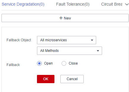

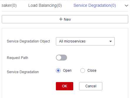

- Click New and select a proper policy. The following table describes the configuration items of service degradation.
Figure 1 Configuring service degradation (for microservices accessed through Spring Cloud)Figure 2 Configuring service degradation (for microservices accessed through Java chassis)
Parameter
Description
Fallback Object
Microservice to be degraded.
When microservices are accessed through Java chassis, one or more methods in the selected microservice are used as the object.
Request Path
This configuration applies to microservices accessed through Spring Cloud.
You can click
and set Method (such as GET, POST, and PUT), Path (request path), and Headers to filter requests.
Fallback
- Open: enables service degradation and sets parameters.
- Close: disables service degradation.
- Click OK.
