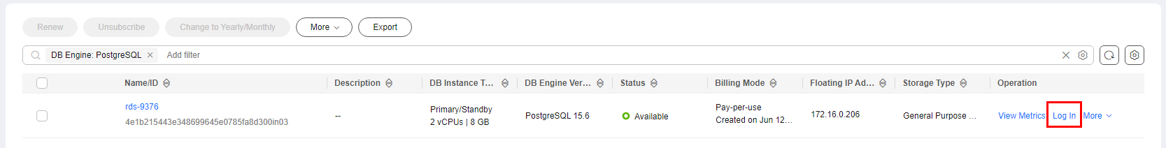

in the upper left corner and select a region. - On the Instances page, locate the DB instance and click Log In in the Operation column. Figure 1 Logging in to an instance
Alternatively, click the DB instance name on the Instances page. On the displayed Summary page, click Log In in the upper right corner.

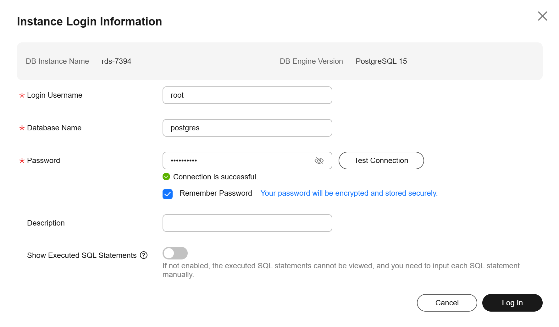

- On the displayed login page, enter the username and password and click Log In.
- Login Username: Enter root.
- Database Name: Enter postgres.
- Password: Enter the root password you specified during instance creation. If you forget the password, you can reset it. For details, see Resetting the Administrator Password to Restore Root Access.
Figure 3 Logging in to an instance

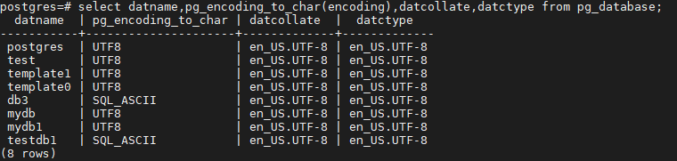

- Querying character sets (encodings) supported by LC_COLLATE and LC_CTYPE
SELECT pg_encoding_to_char(collencoding) AS encoding,collname,collcollate AS "LC_COLLATE",collctype AS "LC_CTYPE" FROM pg_collation;
If encoding is empty, LC_COLLATE supports all character sets.

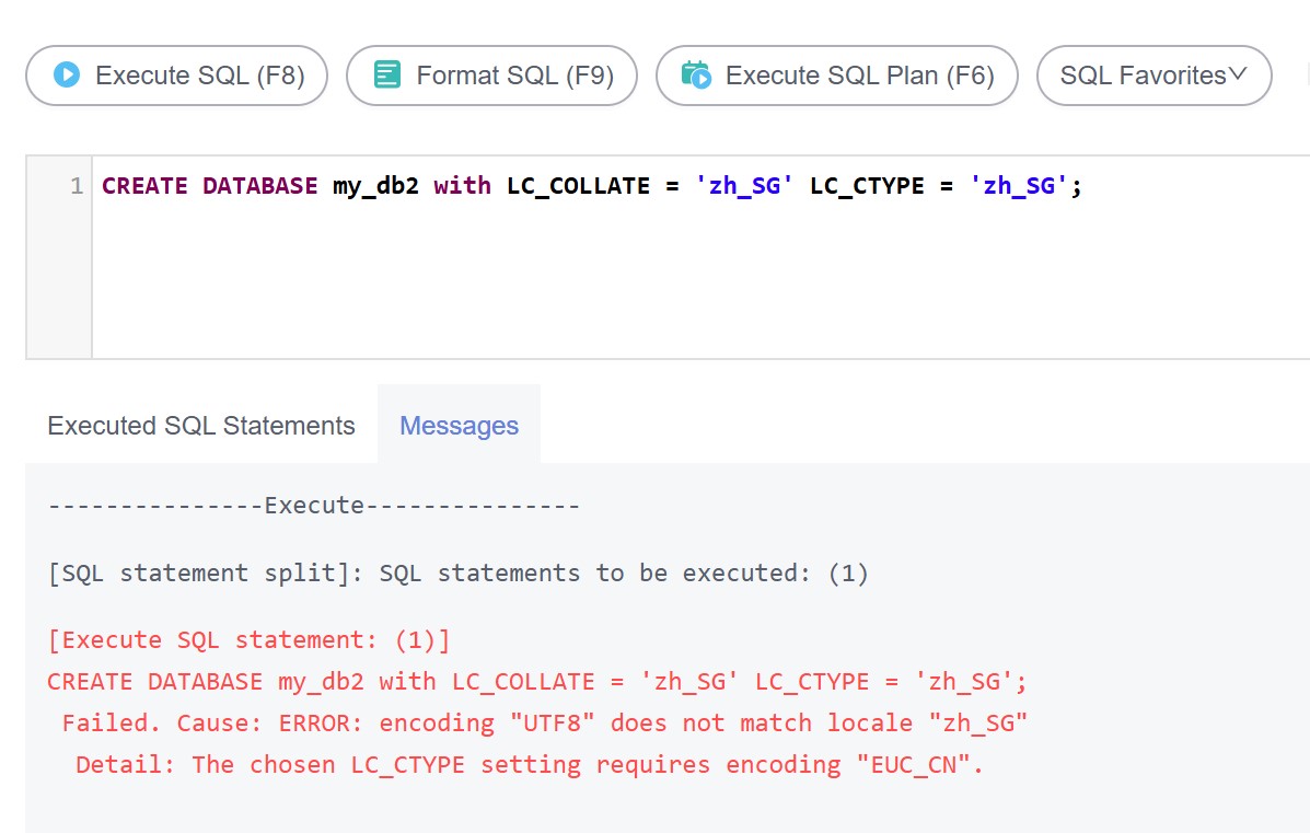

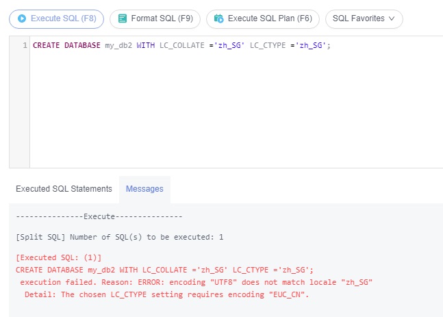

If the specified LC_COLLATE is incompatible with the character set, error information similar to the following is displayed:
- The specified LC_COLLATE and LC_CTYPE must be compatible with the target character set. Otherwise, an error is reported. For details, see Querying character sets (encodings) supported by LC_COLLATE and LC_CTYPE.
