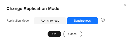

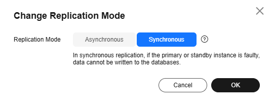

- On the displayed Summary page, find Replication Mode and click Configure under it. In the displayed dialog box, select a mode and click OK. Figure 1 Changing the replication mode
- Check the results on the Summary page.
