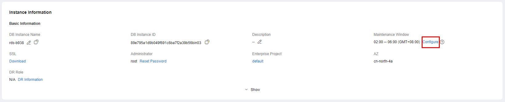

- Log in to the RDS console.
- Click
in the upper left corner and select a region. - On the Instances page, click the target instance name to go to the Summary page. Under Maintenance Window, click Configure. Figure 1 Changing the maintenance window

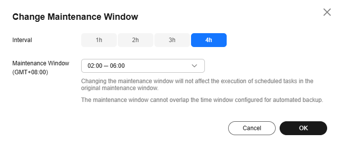

- In the displayed dialog box, select an interval and a time range, and click OK. Figure 2 Changing the maintenance window
Changing the maintenance window does not affect the execution time of the scheduled tasks in the original maintenance period.
