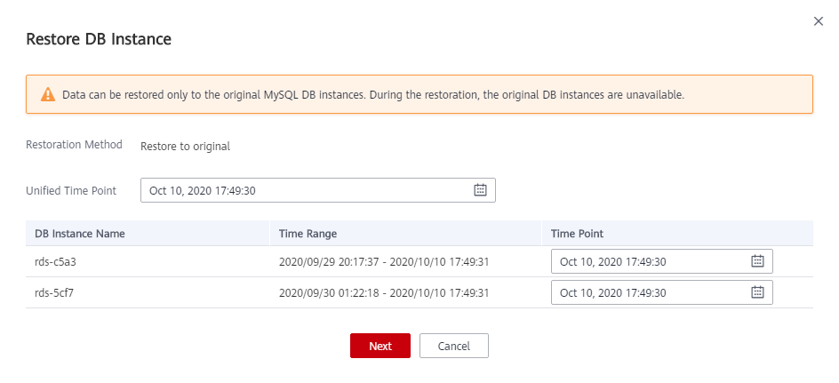

Restoring Multiple DB Instances at a Time
  1. Click in the upper left corner and select a region.
  2. Click in the upper left corner of the page and choose Databases > Relational Database Service.
  3. On the Instances page, select target DB instances and choose More > Restore above the DB instance list.
  4. In the displayed dialog box, set a unified restoration time point, or select different time points for different DB instances.
    Figure 1 Batch restoration
  5. Click Next to confirm the information.
  6. Click OK to submit the batch restoration task.
  7. If you have enabled operation protection, click Send Code in the displayed Identity Verification dialog box and enter the obtained verification code. Then, click OK.
    Two-factor authentication improves the security of your account. For details about how to enable operation protection, see Identity and Access Management User Guide.
