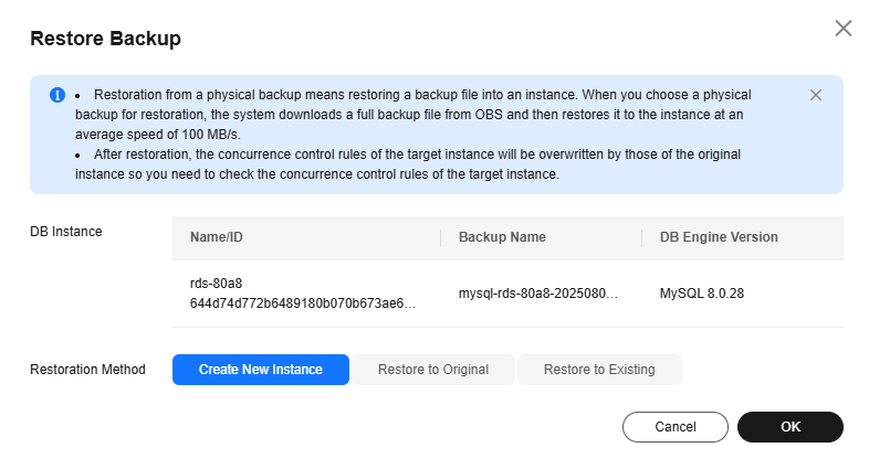

  3. On the Backups page, select the backup to be restored and click Restore in the Operation column.
    Alternatively, click the target DB instance on the Instances page. On the displayed page, choose Backups & Restorations. On the displayed page, select the backup to be restored and click Restore in the Operation column.
  4. Set Restoration Method to Create New Instance and click OK.
    If you have enabled operation protection, click Send Code in the displayed Identity Verification dialog box and enter the obtained verification code. Then, click OK.
    Two-factor authentication improves the security of your account. For details about how to enable operation protection, see Identity and Access Management User Guide.
    Figure 1 Restoring to a new DB instance

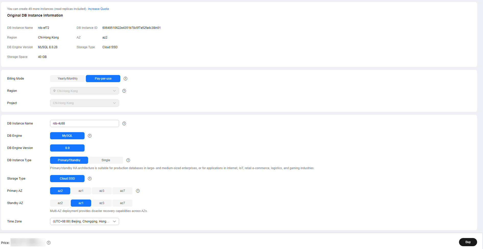

  5. On the displayed page, set required parameters and click Buy.
    • The DB engine and engine version of the new instance are the same as those of the original instance.
    • Storage space of the new DB instance is the same as that of the original DB instance by default and the new instance must be at least as large as the original DB instance.
    • Other settings are the same as those of the original DB instance by default and can be modified. For details, see Buying an RDS for MySQL DB Instance.
    Figure 2 Creating a new instance
