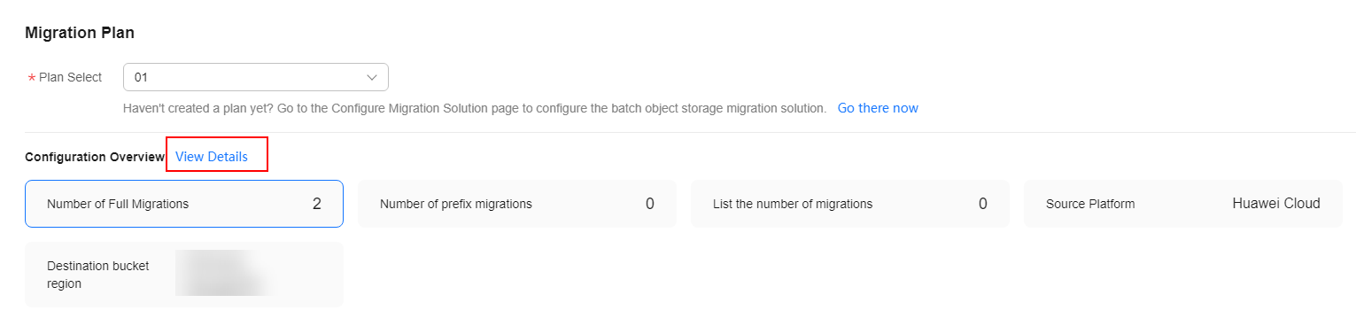

- In the Migration Plan area, select the created migration plan. Then you should view the overview of the migration plan. Click View Details to view more information about the plan.

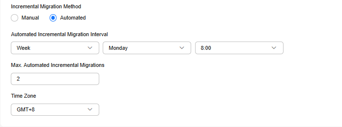

- In the Basic Information area, expand Advanced Settings. Review the incremental migration settings. If Incremental Migration Method is set to Automated, you can modify the number of incremental migrations.
Configuring Incremental Migration Settings
The following table describes the parameters about incremental migration.
Parameter |
Description |
Overwrite Existing During Incremental Migration |
For details, see Table 1. This setting only applies to incremental migration. |
Incremental Migration Method |
- If you select Manual, incremental migration will be executed immediately when the workflow reaches the BatchCreateIncrementalMigrationTasks step.
- If you select Automated, when the workflow reaches the BatchCreateIncrementalMigrationTasks step, you can:
- Manually perform incremental migration immediately when you are waiting for automatic incremental migration.
- Skip incremental migration and verify services.
