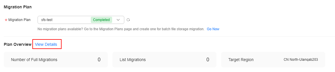

  6. In the Migration Plan area, select the created migration plan. Then you should view the overview of the migration plan. Click View Details to view more information about the plan.
