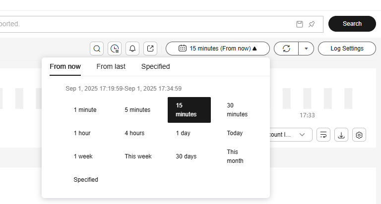

  3. On the Log Search tab page, select a time range from the drop-down list and click Search to view log data accordingly.
    Figure 1 Time range
    There are three types of time range: relative time from now, relative time from last, and specified time. Select a time range as required.
    • From now: queries log data generated in a time range that ends with the current time, such as the previous 1, 5, or 15 minutes. For example, if the current time is 19:20:31 and 1 hour is selected as the relative time from now, the charts on the dashboard display the log data that is generated from 18:20:31 to 19:20:31.
    • From last: queries log data generated in a time range that ends with the current time, such as the previous 1 or 15 minutes. For example, if the current time is 19:20:31 and 1 hour is selected as the relative time from last, the charts on the dashboard display the log data that is generated from 18:00:00 to 19:00:00.
    • Specified: queries log data that is generated in a specified time range. The time range can be up to three months for common users and six months for whitelisted users. If necessary, submit a service ticket to extend the time range to six months.

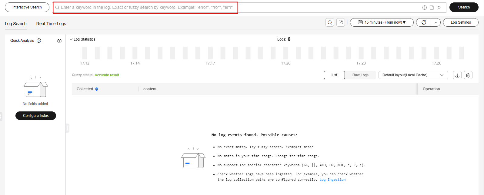

  4. Enter search criteria in the search box by referring to Using Search Syntax to view, search, and filter log data.
    Figure 2 Log search
    1. In the search area, click the search box, enter a keyword or select a field or keyword from the drop-down list, and click Search.
      • System reserved fields include appName, category, clusterId, clusterName, and collectTime. By default, the fields are displayed in simplified mode, and hostIP, hostName, and pathFile are displayed at the beginning. For more system reserved fields, see Configuring Log Indexing.
      • The structured fields are displayed in key:value format.
      • If there is too much content in the log search box, the content can be automatically wrapped and displayed in multiple lines. The height of the search box can be fixed.
    2. In the search area, press the up and down arrows on the keyboard to select a keyword or search syntax from the drop-down list, press Tab to select a keyword or syntax, and click Search.
    3. Click a field for which quick analysis has been enabled to add it to the search box. For details about how to enable quick analysis, see Creating a Quick Analysis Task.
      If the field you click already exists in the search box, it will be replaced by this newly added one. If the field is added for the first time, fields in the search box are searched using the AND operator.

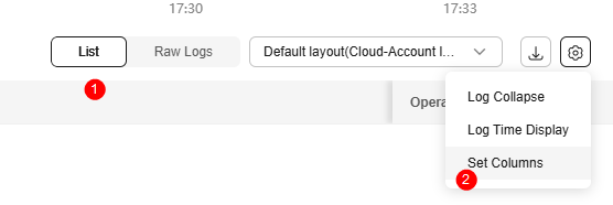

  8. On the Log Search tab page, choose List. You can then set the columns to be displayed.

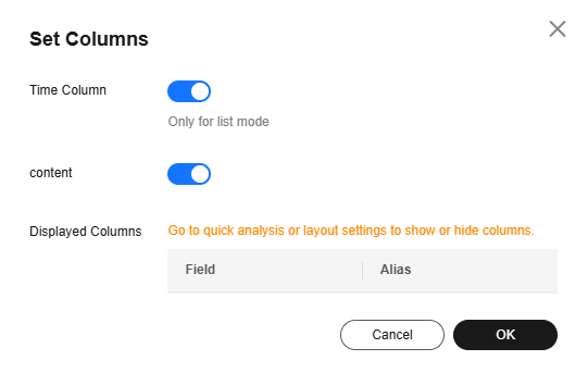

    1. Hover the cursor over and click Set Columns. On the displayed page, set the columns to be displayed.
      Figure 6 Setting columns
    2. By default, the display of the time column and content column is enabled. All visible field names are listed under Displayed Columns. You can set aliases for fields. Properly configured aliases can make your logs easier to read and maintain, improving query efficiency. Click OK.
      Figure 7 Set Columns page
    3. You can display or hide fields as described in Creating a Quick Analysis Task or 7.

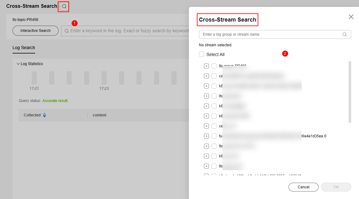

Cross-Stream Search
On the log stream details page, you can search for logs across log streams. This meas you can search for logs in other log streams without exiting the current log search page.
  1. On the log stream details page, click .
    Figure 9 Cross-stream search

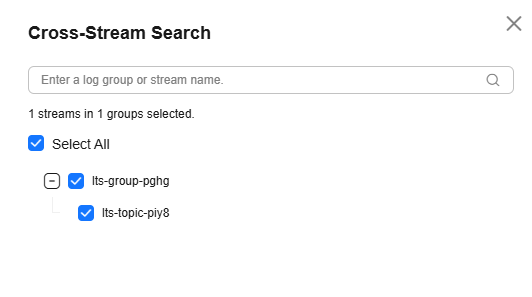

  2. On the displayed page, select one or more target log streams.
    Figure 10 Target log stream
  3. Click OK.
