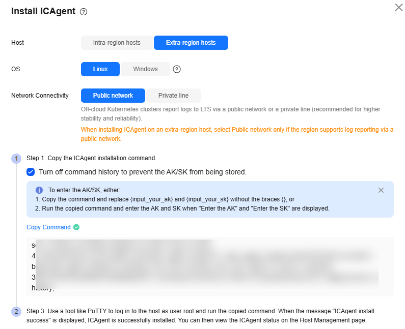

  1. Log in to the LTS console.
  2. Choose Host Management > Hosts in the navigation pane.
  3. Click Install ICAgent.
    Figure 1 Installing ICAgent
  4. Set Host to Extra-region hosts.
  5. Set OS to Linux.
  6. Set Network Connectivity. For extra-region hosts to report logs to LTS in the current region, you are advised to select Private line for higher stability and reliability.
    • If you select Public network, start from 8.
    • If you select Private line, start from 7.
  7. Set LTS Backend Connection. If you select Private line in the previous step, the extra-region host cannot communicate with LTS in the current region by default, and ICAgent installed on the host cannot directly access the network segment used by the Huawei Cloud management plane to report logs. Therefore, you need to configure a network connection solution using either a jump server or VPCEP to connect to LTS.
    • If you set LTS Backend Connection to VPCEP:
      Configure a VPCEP domain name. With the assistance of Huawei Cloud network engineers, configure DNS domain name resolution rules in other regions to resolve VPCEP domain names to specified IP addresses. Then, copy the command as prompted on the Install ICAgent page.
      ping {VPCEP domain name}
      Run this command on the host you want to collect logs from. If the ping command succeeds, the network configuration is correct. Proceed to 8.
    • If you set LTS Backend Connection to Jump server:

      5. On the Install ICAgent page, click Copy Command to copy the SSH tunneling command.

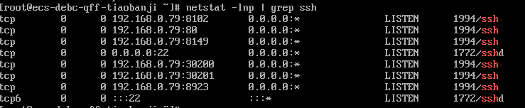

      7. Run the following command to check whether the corresponding ports are being listened to. If the command output similar to Figure 2 is returned, the TCP ports are open.
        netstat -lnp | grep ssh
        Figure 2 Verification results of TCP ports
        If the jump server powers off and restarts, run the command again.

  8. Obtain an AK/SK. For details, see How Do I Obtain an Access Key (AK/SK)? On the Install ICAgent page, copy the ICAgent installation command and replace the AK/SK in the command with the obtained one.
  9. Log in to the extra-region host as user root (by using a remote login tool such as PuTTY) and run the copied command.
    When message "ICAgent install success" is displayed, ICAgent has been installed in the /opt/oss/servicemgr/ directory of the host. You can then choose Host Management > Hosts in the navigation pane of the LTS console to check the ICAgent status.

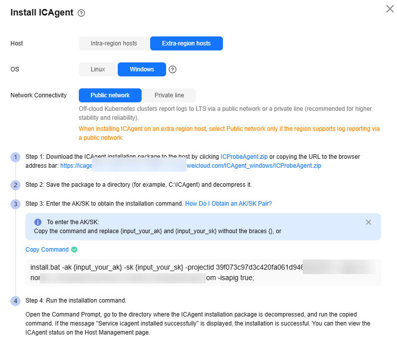

  3. Set Host to Extra-region hosts.
  4. Set OS to Windows.
    Figure 3 Installing ICAgent (Windows)
  5. Set Network Connectivity. Extra-region hosts report logs to LTS via a public network or a private line. The latter is recommended for higher stability and reliability.
    • If you select Public network, start from 7.
    • If you select Private line, start from 6.
  6. Set LTS Backend Connection. If you select Private line in the previous step, the extra-region host cannot communicate with LTS in the current region by default, and ICAgent installed on the host cannot directly access the network segment used by the Huawei Cloud management plane to report logs. Therefore, you need to configure a network connection solution using either a jump server or VPCEP to connect to LTS.

  7. Click the link on the Install ICAgent page to download the ICAgent installation package.
  8. Save the ICAgent installation package to a directory on the Windows host, for example, C:\ICAgent, and decompress the package.
  9. Obtain an AK/SK and save it to replace the AK/SK in the installation command. For details, see How Do I Obtain an Access Key (AK/SK)?
    If you set LTS Backend Connection to Jump Server, you also need to set Connection IP.
    Connection IP: If the jump server communicates with the extra-region host via EIP connection, enter the EIP of the jump server. Conversely, when using a VPC peering connection, enter the internal IP address (private IP address) of the VPC where the jump server locates. For the EIP and private IP address, see 6.c.
  10. On the Install ICAgent page, click Copy Command to copy the ICAgent installation command.
  11. Log in to the Windows host, open the Command Prompt, go to the directory where the ICAgent installation package is decompressed, and run the ICAgent installation command.
    If the message "Service icagent installed successfully" is displayed, the installation is successful. You can then choose Host Management > Hosts in the navigation pane of the LTS console to check the ICAgent status.
