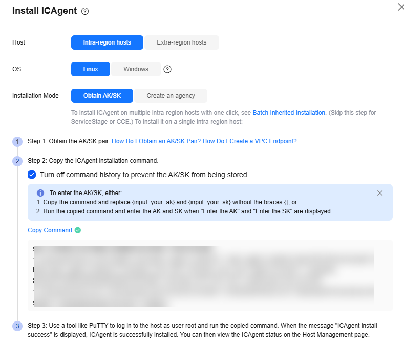

  1. Log in to the management console and choose Management & Deployment > Log Tank Service.
  2. Log in to the LTS console.
  3. Choose Host Management > Hosts in the navigation pane.
  4. Click Install ICAgent in the upper right corner.
    Before installing ICAgent, ensure that the time and time zone of your local browser are consistent with those of the host.
    Figure 1 Installing ICAgent
  5. Set Host to Intra-region hosts.
  6. Set OS to Linux.
  7. If you set Installation Mode to Obtain AK/SK, perform this step and skip 8. Obtain an access key (AK/SK) in advance. You need to enter it when installing ICAgent. AK is used together with SK to sign requests cryptographically, ensuring that the requests are secret, complete, and correct. Ensure that the public account and AK/SK will not be deleted or disabled. If the AK/SK is deleted, ICAgent cannot report data to LTS.
    For details, see How Do I Obtain an Access Key (AK/SK)?
    VPC endpoints are secure and private channels for connecting VPCs to VPC endpoint services. To connect AOM and LTS using a VPC endpoint, create one by referring to How Do I Create a VPC Endpoint on the VPCEP Console?
  8. If you set Installation Mode to Create an agency, this step is required. In this installation mode, you do not need to obtain and enter an AK/SK. ICAgent automatically obtains an AK/SK during agency creation.
    For details, see 8.a

  9. On the Install ICAgent page, click Copy Command to copy the ICAgent installation command.
  10. Log in to the target host and run the copied ICAgent installation command. The following uses a Huawei Cloud ECS as an example. For details, see Logging In to a Linux ECS Using VNC.

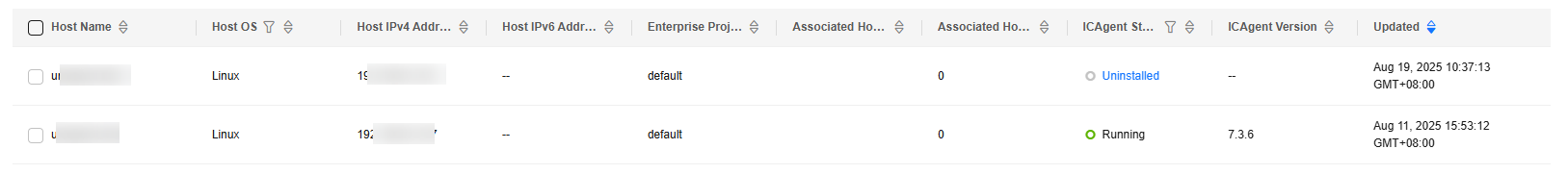

  11. Choose Host Management > Hosts in the navigation pane of the LTS console and check whether the host's ICAgent status is Running.
    The NIC information is obtained by ICAgent installed on the node using the ifconfig command. If inet information is not configured for the NIC, the IPv4 address is not reported, and -- is displayed in the Host IPv4 Address column on the Hosts page. If inet6 information is not configured, the IPv6 address is not reported, and -- is displayed in the Host IPv6 Address column on the Hosts page.
    Figure 3 Hosts
