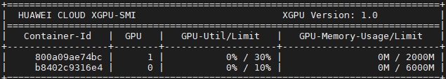

Monitoring Containers Using xgpu-smi
You can use xgpu-smi to view xGPU information, including the container ID, GPU compute usage and allocation, and GPU memory usage and allocation.
The following shows the xgpu-smi monitoring information.
Figure 1 xgpu-smi monitoring information

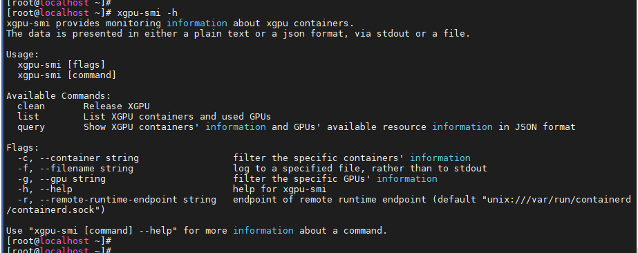

You can run the xgpu-smi -h command to view the help information about the xgpu-smi tool.
Figure 2 xgpu-smi help information
