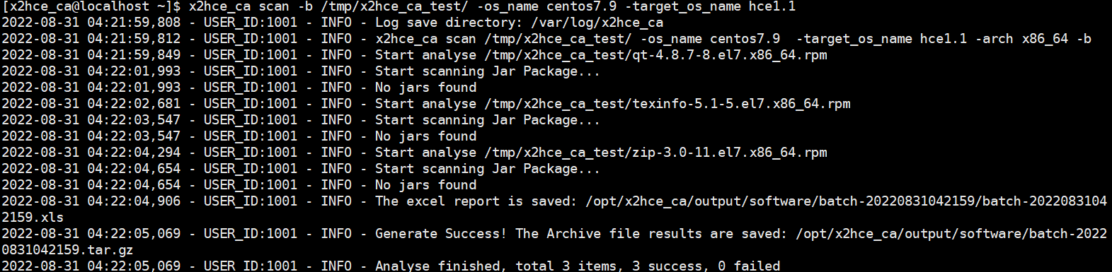

- Analyze the evaluation results.
For example, after the x2hce-ca tool scans three RPM packages in the /tmp/x2hce-ca_test directory, it displays the following outputs.
Figure 1 Scan result

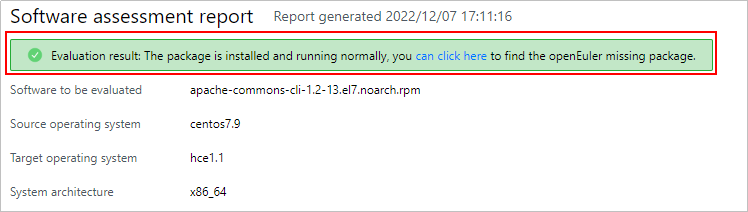

- If the software package is compatible with the target OS, the following message is displayed.
Figure 2 Evaluation result for software package compatibility

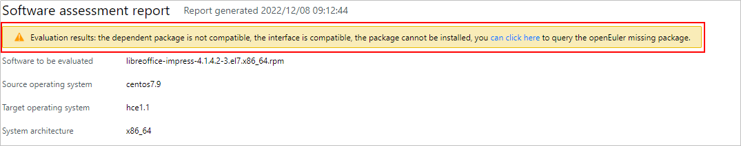

If the software package is not compatible with the target OS, the following message is displayed.
Figure 3 Evaluation result for software package incompatibility
