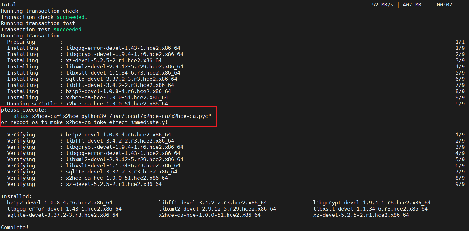

- Install x2hce-ca.
Run yum install -y x2hce-ca-hce to install x2hce-ca. After the installation is complete, the directories listed in Table 1 will be generated.

To install x2hce-ca on CentOS, run yum install -y x2hce-ca-hce-1.0.0-53.hce2.x86_64.rpm. Use the version of your downloaded x2hce-ca-hce.
- To make x2hce-ca take effect, perform operations as prompted after the installation is complete. Figure 1 is an example of the prompt, prompting you to run alias x2hce-ca="x2hce_python39 /usr/local/x2hce-ca/x2hce-ca.pyc" or restart the OS.
