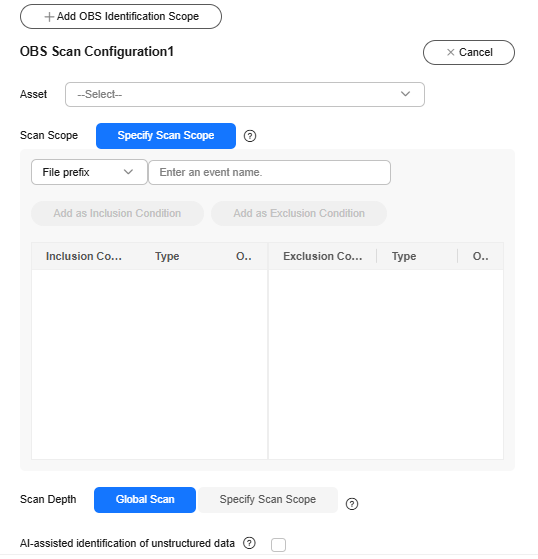

By default, DSC performs a global scan on the selected assets. You can also add a scan scope by referring to this section.
  1. Log in to the DSC console.
  2. Click in the upper left corner of the management console and select a region or project.
  3. In the navigation pane, choose Classification and Grading > Tasks.
  4. Click Create Task. The Create Task page is displayed.
  5. Select the data type, select the name of the asset to be scanned, and click OK.
  6. In the lower left corner of the page, click the button to add an identification scope. You can add multiple scopes at the same time. For details about the parameter settings, see Table 4.
    Table 4 Parameters for configuring the scan scope
    Asset Type
    Configuration Parameter
    Description
    OBS
    Asset
    Select the bucket to be scanned from the drop-down list. You can select multiple buckets.
    Scan Scope
    • File Name Prefix: For example, if you add dsc_ as the inclusion condition, all files whose names start with dsc_ will be scanned.
      A maximum of one inclusion condition can be added for the file name prefix.
    • File name extension: The file name extension contains the file type following the dot (.). For example, the file name extension dsc_security.txt can be security.txt or .txt. Only the files that meet all the filtering conditions are scanned.
      A maximum of one inclusion condition can be added for the file name extension.
    • Directory name: Specifies the directory to be scanned. All files in the specified directory are scanned.
      A maximum of one inclusion condition can be added for the directory.
    After entering the file name prefix/suffix/directory name, click Add as Inclusion Condition to add it as an inclusion condition. Click Add as Exclusion Condition to add it as an exclusion condition.
    For example, if you select the File name prefix, enter the prefix dsc_, and click Add as Inclusion Condition, only the files whose file name prefix is dsc_ are scanned. If you click Add as Exclusion Condition to as the prefix as an exclusion condition, only files whose prefixes are not dsc_ are scanned.
    Scan Depth
    • Global Scan: If this parameter is selected, all data in the specified scope is scanned.
    • Specify Scan Scope: Select Specify Scan Scope and enter the Scan Depth. The depth of the root directory starts at 1 and increases incrementally. However, it must not surpass a depth of 10.
