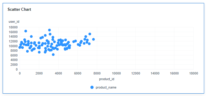

Scatter Chart
A scatter chart is a visual representation of the correlation and distribution of data, consisting of two variables on the X and Y axes. It shows the general trend of the data by presenting how the dependent variable (Y-axis value) changes with the independent variable (X-axis value), while also allowing for observation of the distribution of data from both categorical and color dimensions. By using two sets of data to create multiple coordinate points, the distribution of the points can be examined to determine whether there is a correlation between multiple variables or to summarize the distribution pattern of the coordinate points. This section will show you how to add data and configure styles for scatter charts.

  1. In the top navigation bar on the dashboard creation page, click to create a scatter chart.
  2. Select a dataset in the Data area.
  3. Set parameters on the Field, Style, and Advanced tabs.
  1. Click Update. The system automatically updates the chart.
    Figure 1 Scatter chart
