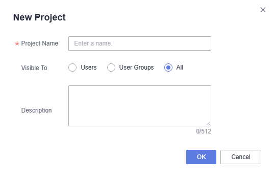

- On the top menu, click Project. On the displayed page, click Create Project.
Figure 1 Creating a project
- Enter the project name, visible type, members, and description.
- The project name can contain up to 50 characters. Only letters, numbers, parentheses (()), square brackets ([]), slashes (/), backslashes (\), vertical bars (|), and underscores (_) are allowed.
- The description can contain a maximum of 512 characters.
- A project is visible to only the creator and members selected during the project creation.
- After entering project information, click OK.
