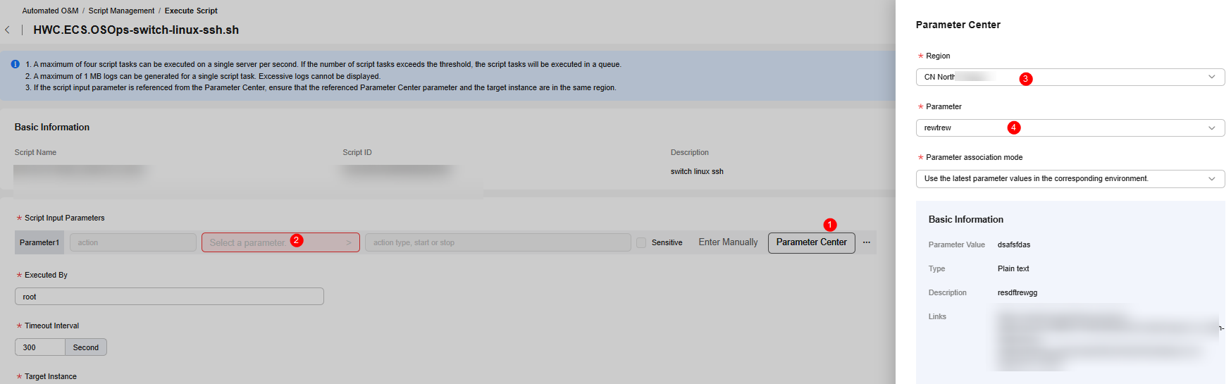

- Set Script Input Parameters.
- Script Input Parameters: The parameters are preset in public scripts and cannot be modified. The script input parameter values can be set manually or selected from the parameter center. Currently, disk cleansing is not supported. You can manually specify parameter values or select a preset parameter value from the parameter center. Select the region where the parameter is located, parameter name, and parameter association mode.
Figure 1 Manually specifying script parametersFigure 2 Selecting script parameters from the parameter center
Table 1 Parameter association modes Parameter Association Mode
Description
Use the latest parameter value in the corresponding environment
This parameter is used during script execution. The value is the latest parameter value obtained from the corresponding region in the parameter center in real time.
