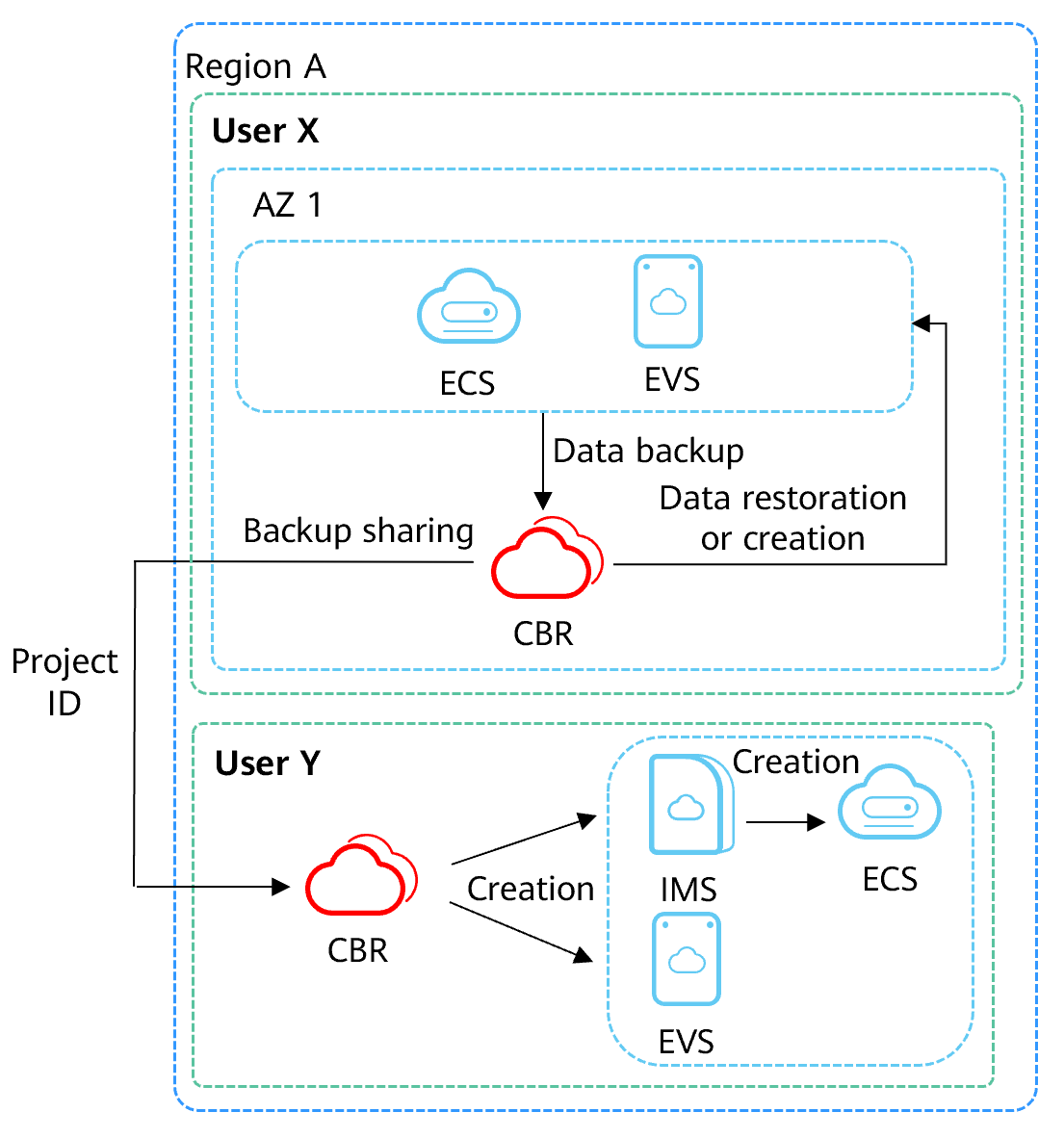

The backup data owner selects the backups to be shared on the CBR console, configures the recipient's project ID in the same region, and initiates the sharing. After the recipient accepts the backup sharing request, the backup data is transmitted to the recipient vault through an encrypted channel. The recipient needs to provide at least one vault whose capacity has not reached the upper limit. Shared backups do not occupy the capacity of the recipient's vault. After the shared backups are stored in the vault, they inherit the retention rules (such as the expiration time and deletion rules) of the original backups to ensure data lifecycle consistency. After accepting the backups, the recipient can quickly create resources such as disks and servers from the backups. In this way, data can be securely and efficiently shared across accounts.
As shown in the figure, user X in region A can share backups with user Y by using the backup sharing function of CBR. User Y can create disks or images using the shared backups in region A and then create ECSs from the images. In this way, services can be quickly deployed across accounts.
- For details about how to share an encryption key, see creating a grant of Data Encryption Workshop (DEW) or creating a resource share of Resource Access Manager (RAM). To obtain the recipient Account ID, hover over the username and choose My Credentials to check the Account ID on the API Credentials page.
- Cloud disk backup encryption depends on an agency that grants KMS access permissions to EVS. If the disk to be backed up is encrypted, the disk backup will be encrypted. The encryption attribute of backups cannot be changed.
When a shared backup is deleted by the sharer, the backup is also deleted from the recipient's account. However, any disks or servers previously created from that backup remain unaffected.

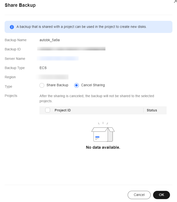

Canceling Backup Sharing
- Log in to the CBR console.
- In the upper left corner, click
and select a region. - Click
and choose Storage > Cloud Backup and Recovery.
- On the cloud server backup page or cloud disk backup page, click the Backups tab and set filter criteria to view the backups.
- Locate the target backup and choose More > Share Backup in the Operation column.
The backup name, server or disk name, backup ID, and backup type are displayed.
- Select Cancel Sharing, select the projects you want to cancel sharing, and click OK.
Figure 3 Cancel Sharing
Return to the backup list, click the backup name to go to the backup details page, and click the Share List tab to view the unshared backups.
If the system displays a message indicating that the backup sharing fails to be canceled, rectify the faults by referring to Failed to Cancel Backup Sharing.
