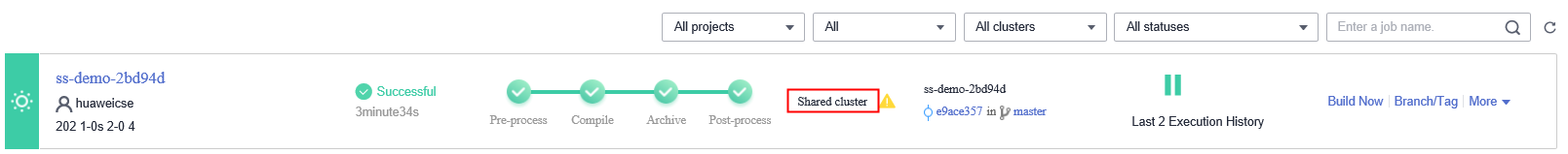

- Log in to ServiceStage and choose Continuous Delivery > Build.
- Select All projects, All, Shared clusters, and All statuses. The filtered results are the clusters you need to switch.
- If there are no results, no further action is required.
- If there are filter results, go to 3.
