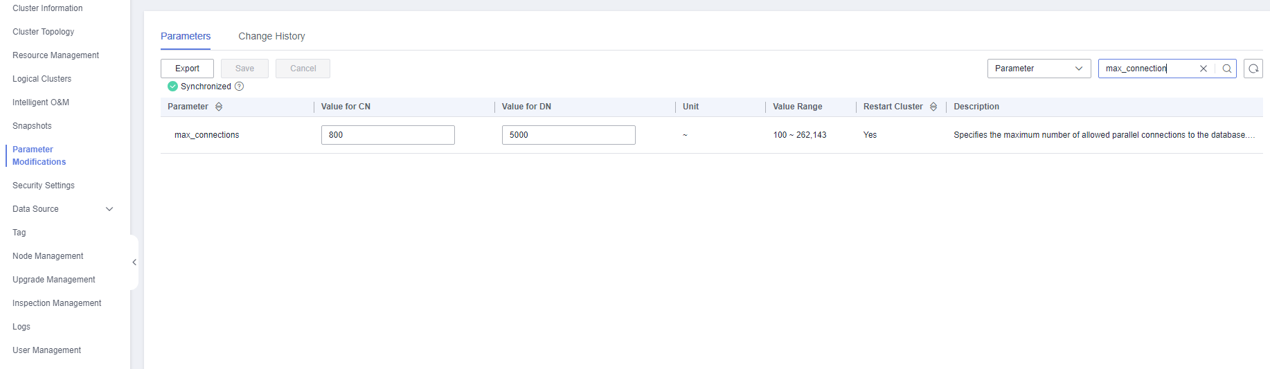

- Click the cluster name to go to the cluster details page. Choose Parameter Modifications, search for max_connections in the search box on the right of the parameter list, and change its value.
Determine whether to increase the value of max_connections for CNs and DNs based on the following rules. The default value is 800 for CNs and 5,000 for DNs.
- Increasing the value of max_connections for CNs will increase the number of concurrent queries connected to DNs. Therefore, you need to increase the values of max_connections and comm_max_stream for DNs.
- Increase the value of max_connections for CNs/DNs by twice. For clusters with a small value, you can increase it by four times.
- To avoid failures in the preparation step, the value of max_prepared_transactions should at least be equal to that of max_connections. This ensures that each session has a prepared transaction in waiting state.
Figure 1 Modifying parameters - Confirm the information and click Save.
