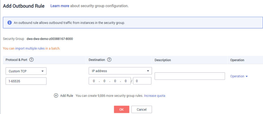

    Ensure that the security group of the ECS contains rules meeting the following requirements. If the rules do not exist, add them to the security group:
    • Transfer Direction: Outbound
    • Protocol: The protocol must contain TCP. For example, TCP or All.
    • Set the port number to the database port that provides services in the data warehouse cluster. For example, set this parameter to 1-65535 or a specific DWS database port.
    • Destination: The IP address set here must contain the IP address of the DWS cluster to be connected. 0.0.0.0/0 indicates any IP address.
      Figure 1 Outbound rule

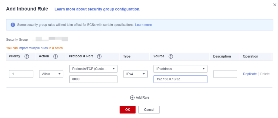

  • The security group rules of the data warehouse cluster must ensure that DWS can receive network access requests from clients.
    Ensure that the DWS cluster's security group contains rules meeting the following requirements. If the rules do not exist, add them to the security group:
    • Transfer Direction: Inbound
    • Port: Set this parameter to the servicing database port of the DWS cluster. Example: 8000.
    • Source: The IP address set here must contain the IP address of the DWS client server. Example: 192.168.0.10/32.
      Figure 2 Inbound rule
