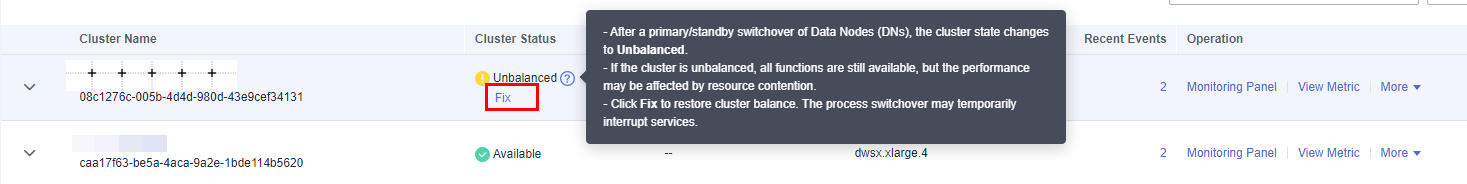

- Choose Dedicated Clusters > Clusters and locate the cluster whose load is unbalanced.
- In the Cluster Status column of the cluster, click Fix under Unbalanced.
- In the dialog box that is displayed, confirm that the service is in off-peak hours, and click Yes. A message will be displayed in the upper right corner, indicating that the switchback request is being processed.
- Check the cluster status. During the switchback, the cluster status is Switching back. After the switchback, the cluster status will change to Available.
