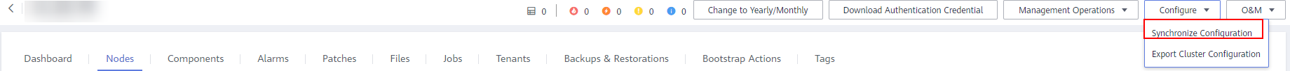

  3. On the cluster details page, choose Configuration > Synchronize Configuration in the upper right corner.
    This operation applies only to MRS 2.x and earlier versions.
    Figure 1 Synchronizing configurations (using MRS 1.9.2 as an example)
  4. In the displayed dialog box, select "Restart services and instances whose configuration have expired" and click OK to restart the service whose configurations have expired.
    When Operation successful is displayed, click Finish. The cluster is started.
