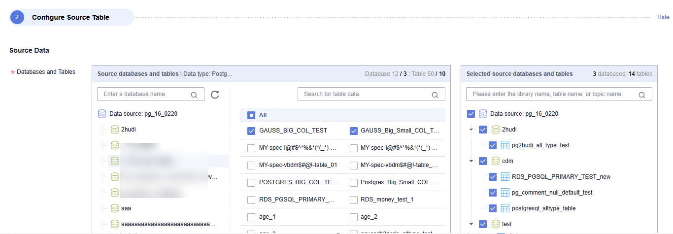

  5. Configure source parameters.
    Select the databases and tables to be synchronized based on the following table.
    Table 5 Selecting the databases and tables to be synchronized
    Synchronization Scenario
    Configuration Method
    Entire DB
    Select the PostgreSQL databases and tables to be migrated.
    Figure 4 Selecting databases and tables
    Both databases and tables can be customized. You can select one database and one table, or multiple databases and tables.

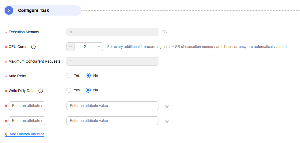

  8. Configure task parameters.
    Table 7 Task parameters
    Parameter
    Description
    Default Value
    Execution Memory
    Memory allocated for job execution, which automatically changes with the number of CPU cores
    8GB
    CPU Cores
    Value range: 2 to 32
    For each CPU core added, 4 GB execution memory and one concurrency are automatically added.
    2
    Maximum Concurrent Requests
    Maximum number of jobs that can be concurrently executed. This parameter does not need to be configured and automatically changes with the number of CPU cores.
    Adding custom attributes
    You can add custom attributes to modify some job parameters and enable some advanced functions. For details, see Job Performance Optimization.
