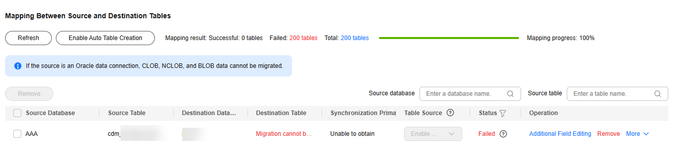

- Refresh and check the mapping between the source and destination tables. In addition, you can modify table attributes, add additional fields, and use the automatic table creation capability to create tables in the destination Hudi database.
Figure 7 Mapping between source and destination tables
- Synchronization Primary Key
A synchronization primary key must be set for a Hudi table. If the source table has no primary key, table mapping will fail.

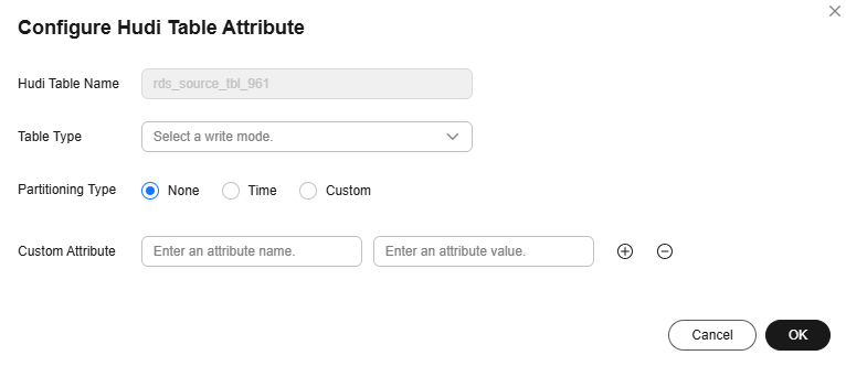

- Edit Table Attribute
Click Edit Table Attributes in the Operation column to configure Hudi table attributes, including the table type, partition type, and custom attributes.
Figure 8 Configuring the Hudi table attributes
- Table Type: Hudi table type. Select MERGE_ON_READ or COPY_ON_WRITE.
- Partition Type: partition type of the Hudi table. Select No partition, Time, or Custom.
- For Time, you need to specify a source field name and select a time conversion format.
For example, you can specify the source field name src_col_1 and select a time conversion format, for example, day(yyyyMMdd), month(yyyyMM), or year(yyyy). During automatic table creation, a cdc_partition_key field is created in the Hudi table by default. The system formats the value of the source field (src_col_1) based on the configured time conversion format and writes the value to cdc_partition_key.
- Custom partitions do not support timestamp fields. If you use timestamp fields, the job will fail.
- Customize table attributes. Some advanced functions of a single table can be configured using parameters. For details about the parameters, see the table that lists Hudi advanced configurations.

- Automatic table creation: Click Auto Table Creation to automatically create tables in the destination database based on the configured mapping policy. After the tables are created, Existing table is displayed for them.
Figure 9 Automatic table creation
- DataArts Migration supports only automatic table creation. You need to manually create databases and schemas at the destination before using this function.
- For details about the field type mapping for automatic table creation, see Field Type Mapping.
- An automatically created Hudi table contains three audit fields: cdc_last_update_date, logical_is_deleted, and _hoodie_event_time. The _hoodie_event_time field is used as the pre-aggregation key of the Hudi table.
