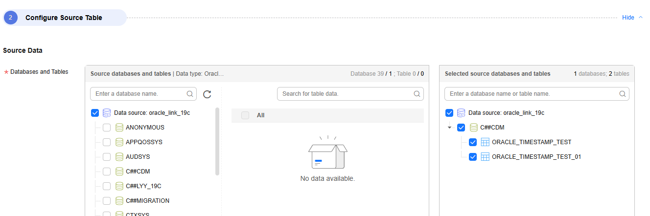

- Configure source parameters.
Select the databases and tables to be synchronized based on the following table.
Table 5 Selecting the Kafka topics to be synchronized Synchronization Scenario
Configuration Method
Entire DB
Select the Oracle databases and tables to be migrated.Figure 4 Selecting databases and tables
Both databases and tables can be customized. You can select one database and one table, or multiple databases and tables.

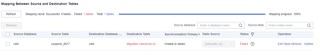

- Refresh and check the mapping between the source and destination tables. In addition, you can modify table attributes, add additional fields, and use the automatic table creation capability to create tables in the destination GaussDB(DWS) database.Figure 7 Mapping between source and destination tables

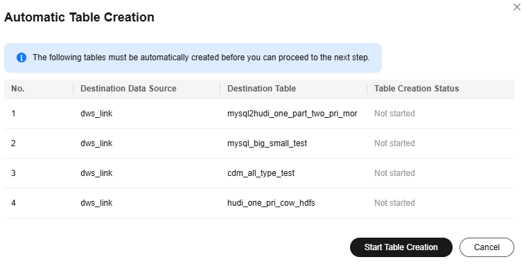

- Automatic table creation: Click Auto Table Creation to automatically create tables in the destination database based on the configured mapping policy. After the tables are created, Existing table is displayed for them. Figure 8 Automatic table creation
- DataArts Migration supports only automatic table creation. You need to manually create databases and schemas at the destination before using this function.
- For details about the field type mapping for automatic table creation, see Field Type Mapping.
