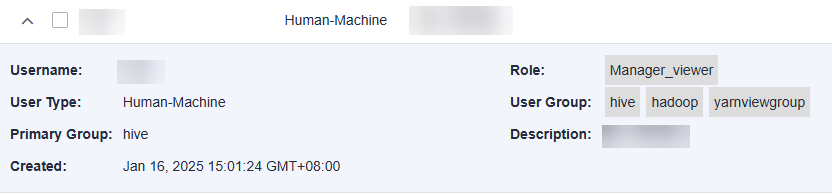

The MRS user must have read and write permissions for the Hadoop and Hive components. You are advised to assign the roles and user groups shown in the following figure to the MRS user.
Figure 1 Minimal permissions for MRS Hudi
For details, see .

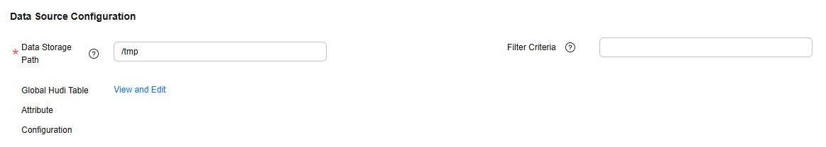

      Data Storage Path
      N/A
      N/A
      Warehouse path when tables are automatically created in Hudi. A subdirectory is created in the warehouse path for each table. You can enter an HDFS or OBS path. The path format is as follows:
      • OBS path: obs://bucket/warehouse
      • HDFS path: /tmp/warehouse
      Global Configuration of Hudi Table Attributes
      N/A
      N/A
      Some advanced functions can be configured using parameters. For details, see Hudi advanced parameters.

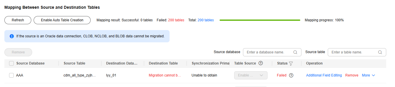

  7. Refresh and check the mapping between the source and destination tables. In addition, you can modify table attributes, add additional fields, and use the automatic table creation capability to create tables in the destination Hudi database.
    Figure 8 Mapping between source and destination tables
    • Synchronization Primary Key
      A synchronization primary key must be set for a Hudi table. If the source table has no primary key, table mapping will fail.
    • Edit Table Attribute
      Click Edit Table Attributes in the Operation column to configure Hudi table attributes, including the table type, partition type, and custom attributes.
      Figure 9 Configuring the Hudi table attributes
      • Table Type: Hudi table type. Select MERGE_ON_READ or COPY_ON_WRITE.
      • Partition Type: partition type of the Hudi table. Select No partition, Time, or Custom.
        • For Time, you need to specify a source field name and select a time conversion format.
          For example, you can specify the source field name src_col_1 and select a time conversion format, for example, day(yyyyMMdd), month(yyyyMM), or year(yyyy). During automatic table creation, a cdc_partition_key field is created in the Hudi table by default. The system formats the value of the source field (src_col_1) based on the configured time conversion format and writes the value to cdc_partition_key.
        • Custom partitions do not support timestamp fields. If you use timestamp fields, the job will fail.
      • Customize table attributes. Some advanced functions of a single table can be configured using parameters. For details about the parameters, see the table that lists Hudi advanced configurations.
    • Edit additional fields: Click Additional Field in the Operation column to add custom fields to the destination Hudi table. For a new table, you can add additional fields to the existing fields in the source table. You can customize the field name, select the field type, and enter the field value.
      • Field Name: name of the new field in the destination Hudi table
      • Field Type: Type of the new field in the destination Hudi table
      • Field Value: Value source of the new field in the destination Hudi table
        Table 8 Additional field value obtaining mode
        Type
        Example
        Constant
        Digits, letters, and special characters are supported. Color emoticons may cause a job submission failure.
        Built-in variable
        • Source host IP address: source.host
        • Source schema name: source.schema
        • Source table name: source.table
        • Destination schema name: target.schema
        • Destination table name: target.table
        Source table field
        Any field in the source table
        Do not change the name of the source table field when the job is running. Otherwise, the job may be abnormal.
        UDF
        • substring(#col, pos[, len]): obtains a substring of a specified length from the source column name. The substring range is [pos, pos+len).
        • date_format(#col, time_format[, src_tz, dst_tz]): formats the source column name based on a specified time format. The time zone can be converted using src_tz and dst_tz.
        • now([tz]): obtains the current time in a specified time zone.
        • if(cond_exp, str1, str2): returns str1 if the condition expression cond_exp is met and returns str2 otherwise.
        • concat(#col[, #str, ...]): concatenates multiple parameters, including source columns and strings.
        • from_unixtime(#col[, time_format]): formats a Unix timestamp based on a specified time format.
        • unix_timestamp(#col[, precision, time_format]): converts a time into a Unix timestamp of a specified time format and precision. time_format must be the same as that in the source data.
    • Automatic table creation: Click Auto Table Creation to automatically create tables in the destination database based on the configured mapping policy. After the tables are created, Existing table is displayed for them.
      Figure 10 Automatic table creation
      • DataArts Migration supports only automatic table creation. You need to manually create databases and schemas at the destination before using this function.
      • For details about the field type mapping for automatic table creation, see Field Type Mapping.
      • An automatically created Hudi table contains three audit fields: cdc_last_update_date, logical_is_deleted, and _hoodie_event_time. The _hoodie_event_time field is used as the pre-aggregation key of the Hudi table.
