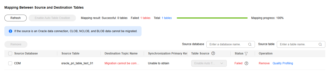

- Update the mapping between the source table and destination table and check whether the mapping is correct. Figure 6 Mapping between source and destination tables
