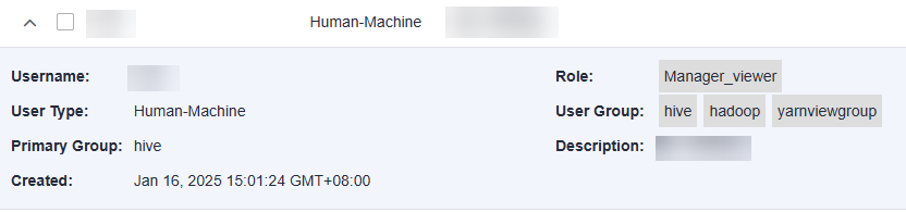

Source database connection account | The MRS user must have the read and write permissions on corresponding Kafka topics, that is, the user must belong to the kafka/kafkaadmin/kafkasuperuser user group. NOTE: A common Kafka user can access a topic only after being granted the read and write permissions on the topic by the Kafka administrator. |
Destination database connection account | The MRS user must have read and write permissions for the Hadoop and Hive components. You are advised to assign the roles and user groups shown in the following figure to the MRS user. Figure 1 Minimal permissions for MRS Hudi ![]() For details, see . |

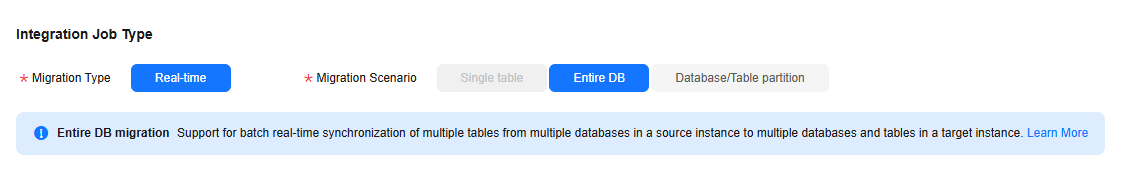

- Select a job type. The default migration type is Real-time. The migration scenario is Single table.Figure 3 Setting the job type
For details about synchronization scenarios, see Synchronization Scenarios.

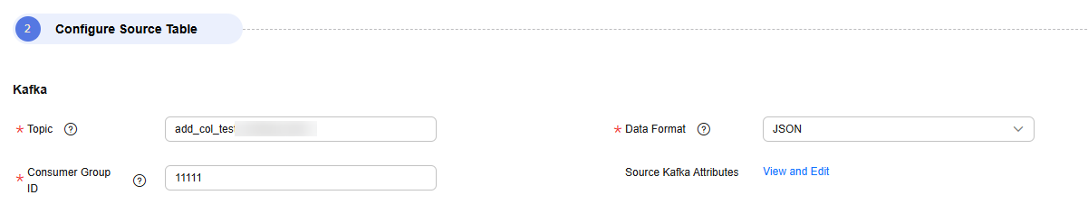

- TopicEnter a Kafka topic to be migrated.Figure 5 Entering a Kafka topic
- Data FormatFormat of the message content in the source Kafka topic. DataArts Migration can process the following types of messages:
- JSON: Messages can be parsed in JSON format.
- CSV: Messages can be parsed using specified separators in CSV format.
- TEXT: The entire message is synchronized as text.
- Consumer Group ID
A consumer subscribes to a topic. A consumer group consists of one or more consumers. DataArts Migration allows you to specify the Kafka consumer group to which a consumption action belongs.
- Source Kafka Attributes
You can set Kafka attributes and add the properties. prefix. The job will automatically remove the prefix and transfer the attributes to the Kafka client. For details about the parameters, see the configuration descriptions in the Kafka documentation.

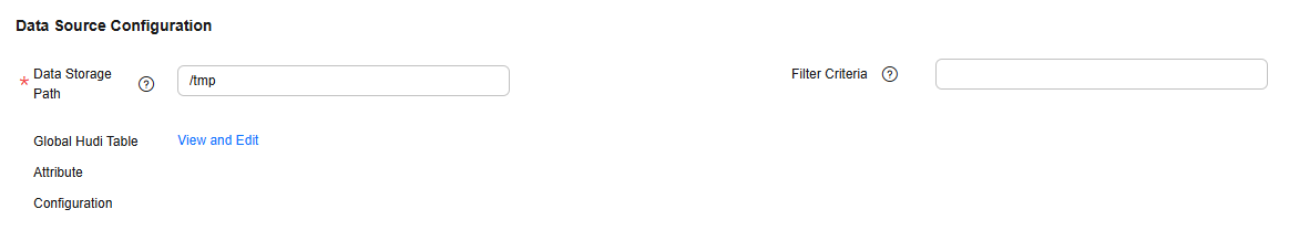

- Data Storage Path
Warehouse path when tables are automatically created in Hudi. A subdirectory is created in the warehouse path for each table. You can enter an HDFS or OBS path. The path format is as follows:
- OBS path: obs://bucket/warehouse
- HDFS path: /tmp/warehouse
- Global Hudi Table Attribute Configuration
Some advanced functions can be configured using parameters. For details, see Hudi advanced parameters.

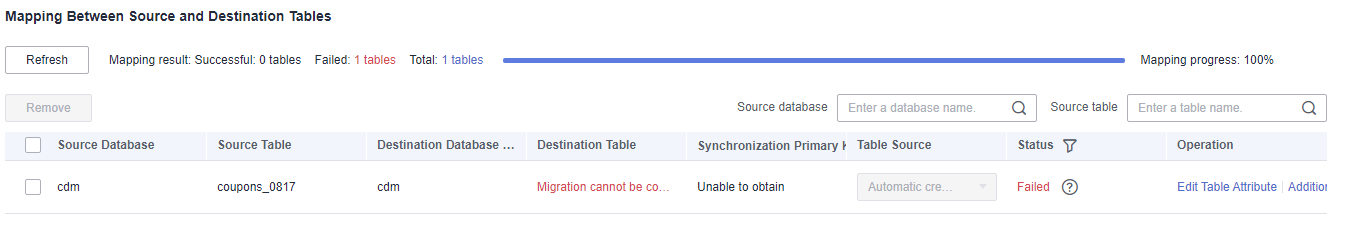

- Refresh and check the mapping between the source and destination tables. In addition, you can modify table attributes, add additional fields, and use the automatic table creation capability to create tables in the destination Hudi database.Figure 7 Mapping between source and destination tables
- Synchronization Primary Key
The primary key must be set for Hudi tables. If the source table has no primary key, you must manually select the primary key during field mapping.
- Partition Field
If no Hudi table is available at the destination, you can select a maximum of five mapped destination fields as partition fields. DataArts Migration automatically specifies partitions for a Hudi table when creating the table, and directories are automatically generated for the partitions when data is written to the Hudi table.
The field selection sequence affects the partition level. For example, if par1 and par2 are selected as partition fields, par1 is a level-1 partition and par2 is a level-2 partition. A maximum of five levels of partitions are supported.

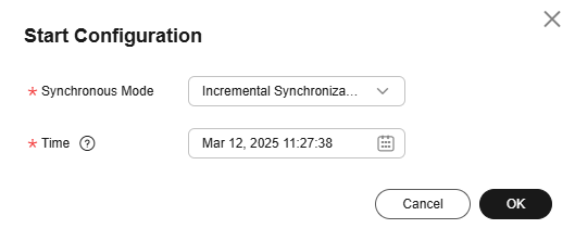

After submitting the job, click Start on the job development page. In the displayed dialog box, set required parameters and click OK.
Figure 9 Starting the job
Table 8 Parameters for starting the job Parameter
Description
Offset Parameter
- Earliest: Data consumption starts from the earliest offset of the Kafka topic.
- Latest: Data consumption starts from the latest offset of the Kafka topic.
- Time Range: Data consumption starts from the offset of the Kafka topic obtained based on the time.
Minimum Timestamp
This parameter is required if Offset Parameter is set to Time Range. It specifies the start time of synchronization.
NOTE:If you set a time earlier than the earliest offset of Kafka messages, data consumption starts from the earliest offset by default.
