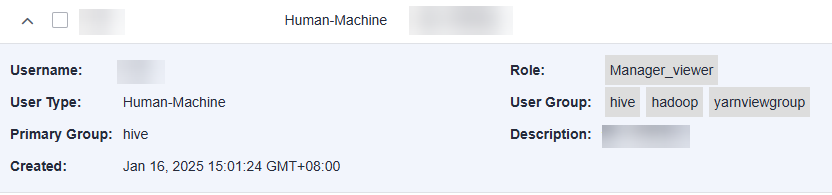

| Destination database account | The MRS user must have read and write permissions for the Hadoop and Hive components. You are advised to assign the roles and user groups shown in the following figure to the MRS user. Figure 1 Minimal permissions for MRS Hudi For details, see . |
- You are advised to create independent database accounts for DataArts Migration task connections to prevent task failures caused by password modification.
- After changing the account passwords for the source or destination databases, modify the connection information in Management Center as soon as possible to prevent automatic retries after a task failure. Automatic retries will lock the database accounts.

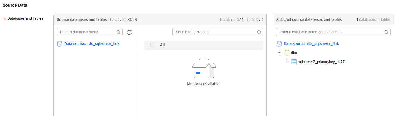

- Select the SQL Server databases and tables to be migrated. Figure 6 Selecting databases and tables
Both databases and tables can be customized. You can select one database and one table, or multiple databases and tables.

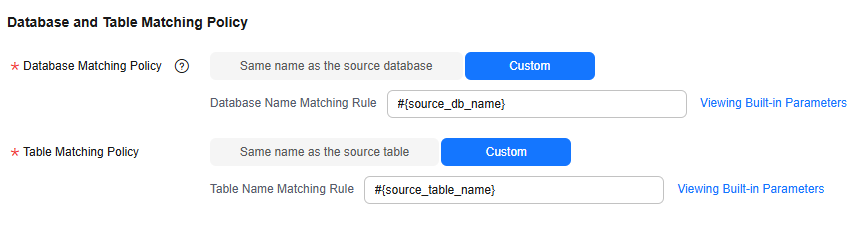

- Set Database and Table Matching Policy.
For details about the matching policy between source and destination databases and tables in each synchronization scenario, see the following table.
Table 5 Database and table matching policy Synchronization Scenario
Configuration Method
Entire DB
- Database Matching Policy
- Same name as the source database: Data will be synchronized to the Hudi database with the same name as the source SQL Server schema.
- Custom: Data will be synchronized to the Hudi database you specify.
- Table Matching Policy
- Same name as the source table: Data will be synchronized to the Hudi table with the same name as the source SQL Server schema.
- Custom: Data will be synchronized to the Hudi table you specify. Figure 7 Database and table matching policy in the entire database migration scenario
NOTE:When you customize a matching policy, you can use built-in variables #{source_db_name} and #{source_table_name} to identify the source database name and table name. The table matching policy must contain #{source_table_name}.

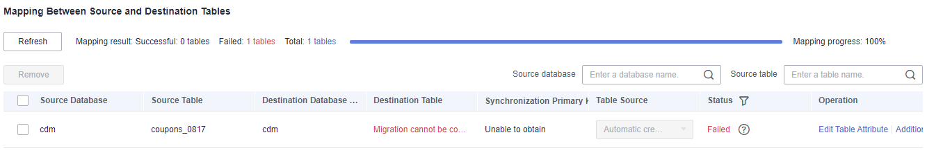

- Refresh and check the mapping between the source and destination tables. In addition, you can modify table attributes, add additional fields, and use the automatic table creation capability to create tables in the destination Hudi database. Figure 9 Mapping between source and destination tables
- Synchronization Primary Key
The primary key must be set for Hudi tables. If the source table has no primary key, you must manually select the primary key during field mapping.

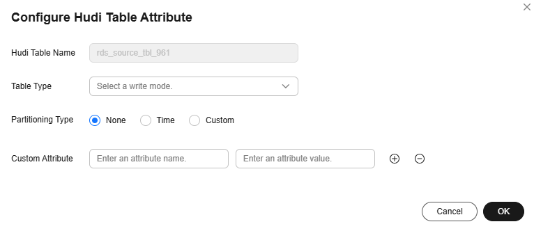

Click Edit Table Attributes in the Operation column to configure Hudi table attributes, including the table type, partition type, and custom attributes.
Figure 10 Configuring the Hudi table attributes
- Table Type: Hudi table type. Select MERGE_ON_READ or COPY_ON_WRITE.
- Partition Type: partition type of the Hudi table. Select No partition, Time, or Custom.
- For Time, you need to specify a source field name and select a time conversion format.
For example, you can specify the source field name src_col_1 and select a time conversion format, for example, day(yyyyMMdd), month(yyyyMM), or year(yyyy). During automatic table creation, a cdc_partition_key field is created in the Hudi table by default. The system formats the value of the source field (src_col_1) based on the configured time conversion format and writes the value to cdc_partition_key.
- Custom partitions do not support timestamp fields. If you use timestamp fields, the job will fail.
