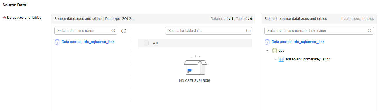

  5. Configure source parameters.
    Select the SQL Server databases and tables to be migrated.
    Figure 5 Selecting databases and tables
    Both databases and tables can be customized. You can select one database and one table, or multiple databases and tables.

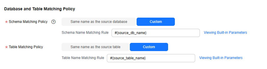

  6. Configure destination parameters.
    • Set Database and Table Matching Policy.
      For details about the matching policy between source and destination databases and tables in each synchronization scenario, see the following table.
      Table 5 Database and table matching policy
      Synchronization Scenario
      Configuration Method
      Entire DB
      • Schema Matching Policy
        • Same name as the source database: Data will be synchronized to the GaussDB(DWS) schema with the same name as the source SQL Server database.
        • Custom: Data will be synchronized to the GaussDB(DWS) schema you specify.
      • Table Matching Policy
        • Same name as the source table: Data will be synchronized to the GaussDB(DWS) table with the same name as the source SQL Server table.
        • Custom: Data will be synchronized to the GaussDB(DWS) table you specify.
          Figure 6 Database and table matching policy in the entire database migration scenario
          NOTE:
          When you customize a matching policy, you can use built-in variables #{source_db_name} and #{source_table_name} to identify the source database name and table name. The table matching policy must contain #{source_table_name}.

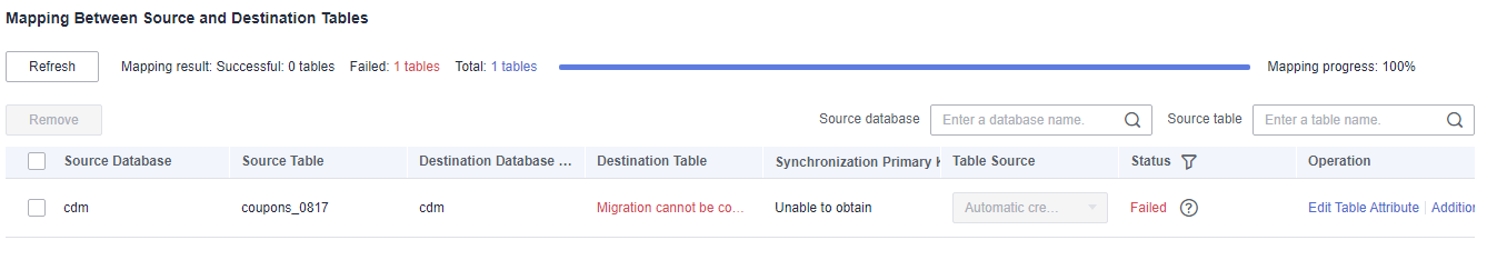

  7. Refresh and check the mapping between the source and destination tables. In addition, you can modify table attributes, add additional fields, and use the automatic table creation capability to create tables in the destination GaussDB(DWS) database.
    Figure 8 Mapping between source and destination tables
