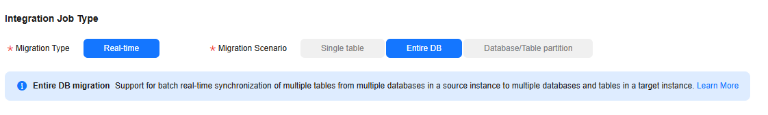

  3. Select a job type. The default migration type is Real-time. The migration scenarios include Single table and Entire DB.
    Figure 2 Setting the migration job type
    For details about synchronization scenarios, see Synchronization Scenarios.

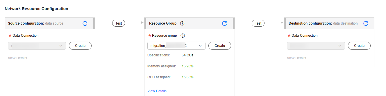

  4. Configure network resources. Select the created DMS for Kafka and OBS data connections and the migration resource group for which the network connection has been configured.
    Figure 3 Selecting data connections and a migration resource group
    If no data connection is available, click Create to go to the Manage Data Connections page of the Management Center console and click Create Data Connection to create a connection. For details, see Configuring DataArts Studio Data Connection Parameters.

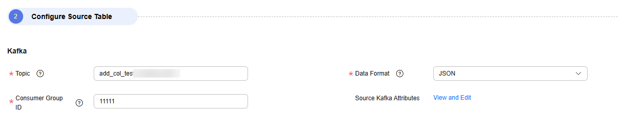

  5. Configure source parameters.
    • Select the Kafka topics to be synchronized in different migration scenarios based on the following table.
      Table 5 Selecting the Kafka topics to be synchronized
      Configuration Method
      Single table
      Enter a Kafka topic to be migrated.
      Figure 4 Entering a Kafka topic
      Entire DB
      Select the Kafka topics to be migrated.
      Figure 5 Selecting Kafka topics
    • Data Format
      Format of the message content in the source Kafka topic. DataArts Migration can process the following types of messages:
      • JSON: Messages can be parsed in JSON format.
      • CSV: Messages can be parsed using specified separators in CSV format.
      • TEXT: The entire message is synchronized as text.
    • Consumer Group ID
      A consumer subscribes to a topic. A consumer group consists of one or more consumers. DataArts Migration allows you to specify the Kafka consumer group to which a consumption action belongs.
    • Source Kafka Attributes
      You can set Kafka attributes and add the properties. prefix. The job will automatically remove the prefix and transfer the attributes to the Kafka client. For details about the parameters, see the configuration descriptions in the Kafka documentation.

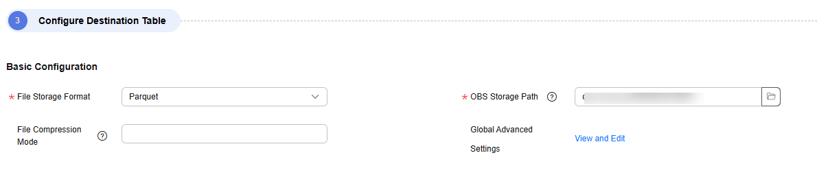

  6. Configure destination parameters.
    Figure 6 Configuring destination OBS parameters
    • File Storage Format
      Format of the files to be written to OBS. Parquet, SequenceFile, and TextFile are supported.
    • File Compression Mode
      Compression mode of the data to be written to OBS files. By default, data is not compressed. The following compression modes are supported:
      • Parquet format: UNCOMPRESSED or SNAPPY
      • SequenceFile format: UNCOMPRESSED, SNAPPY, GZIP, LZ4, or BZIP2.
      • TextFile format: UNCOMPRESSED
    • OBS Path
      Path for storing OBS files. You can enter the #{source_Topic_name} built-in variable so that topics at the source can be written to different paths. An example path is obs://bucket/dir/test.db/prefix_#{source_Topic_name}_suffix/.

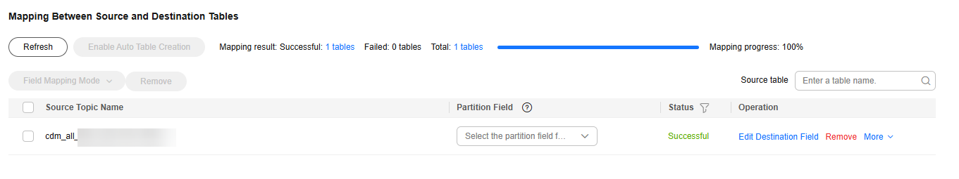

  7. Refresh the mapping between the source table and destination table. Click Edit Destination Field to check the fields to be written to the destination and configure partition fields as needed.
    Figure 7 Mapping between source and destination tables
    • Partition Field
      After you configure partition fields, a partition directory is automatically generated when data is written to OBS. The directory name is in Partition field=Partition value format. In addition, the field selection sequence affects the partition level. For example, if par1 and par2 are selected as partition fields, par1 is a level-1 partition and par2 is a level-2 partition. A maximum of five levels of partitions are supported.
    • Edit Destination Field
      DataArts Migration automatically parses source messages based on the selected source message format and generates corresponding fields. You can customize the names, types, and values of the fields.
      • Field Name: name of the field to be written to the destination OBS file. The name must contain at least one letter and can contain underscores (_) and hyphens (-), but cannot contain only digits.
      • Field Type: type of the field to be written to the destination OBS file. The following types are supported: STRING, BOOLEAN, INTEGER, LONG, FLOAT, DOUBLE, SHORT, DECIMAL, DATE, and TIMESTAMP.
      • Field Value: value source of the field to be written to the destination OBS file
        Table 7 Destination field value obtaining mode
        Type
        Value
        Manually assigned value
        Any character
        Built-in variable
        Kafka metadata, including six fields: __key__, __value__, __Topic__, __partition__, __offset__, and __timestamp__.
        Source table field
        Any field parsed from the source Kafka topic message
        NOTE:
        If the source Kafka message is in nested JSON format, this link can parse field values at different levels (including arrays whose subscript indexes start from 1).
        The following is an example of the JSON content:
            "col1": "1",
            "col2": "2",
            "level1": {
                "level2": [
                        "level3": "test"
        You can obtain test using level1.level2[1].level3 and use it as the value of a field at the destination.

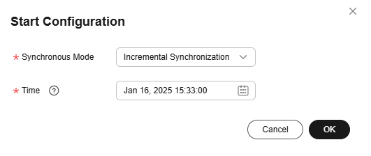

    After submitting the job, click Start on the job development page. In the displayed dialog box, set required parameters and click OK.
    Figure 9 Starting the job
    Table 9 Parameters for starting the job
    Parameter
    Description
    Offset Parameter
    • Earliest: Data consumption starts from the earliest offset of the Kafka topic.
    • Latest: Data consumption starts from the latest offset of the Kafka topic.
    • Start/End time: Data consumption starts from the offset of the Kafka topic obtained based on the time.
    Time
    This parameter is required if Offset is set to Start/End time. It specifies the start time of synchronization.
    NOTE:
    If you set a time earlier than the earliest offset of Kafka messages, data consumption starts from the earliest offset by default.
