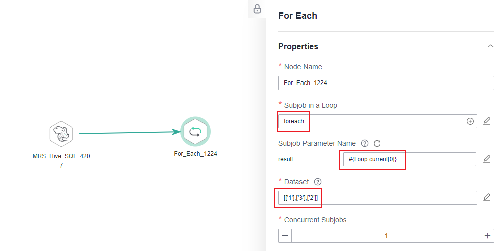

Figure 1 shows an example For Each node. As shown in the figure, the parameter name of the foreach subjob is result, and the parameter value is the traversal of the one-dimensional array dataset [['1'],['3'],['2']] (that is, the value is 1, 3, and 2 in the first, second, and third loop, respectively).

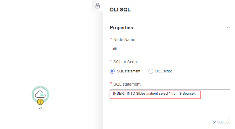

- Access the DataArts Studio DataArts Factory page, choose Develop Job. Create a job named ForeachDemo, select the DLI SQL node, and configure the job as shown in Figure 3. In the DLI SQL statement, set the variable to be replaced to ${}. The following SQL statement is used to import all data in the ${Source} table to the ${Destination} table. ${fromTable} and ${toTable} are the variables. The SQL statement is as follows:
INSERT INTO ${Destination} select * from ${Source};
Do not use the #{Job.getParam("job_param_name")} EL expression because this expression can only obtain the values of the parameters configured in the current job, but cannot obtain the parameter values transferred from the parent job or the global variables configured in the workspace. The expression only works for the current job.
To obtain the parameter values passed from the parent job and the global variables configured for the workspace, you are advised to use the ${job_param_name} expression.

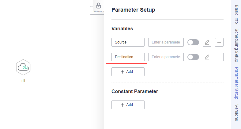

- After configuring the SQL statement, configure parameters for the subjob. You only need to set the parameter names, which are used by the For Each operator of the ForeachDemo_master job to identify subjob parameters. Figure 4 Configuring subjob parameters

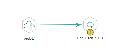

- Create a master job named ForeachDemo_master where the For Each node is located.
- Access the DataArts Studio DataArts Studio page and choose Develop Job. Create a data development master job named ForeachDemo_master. Select the DLI SQL and For Each nodes and click and drag

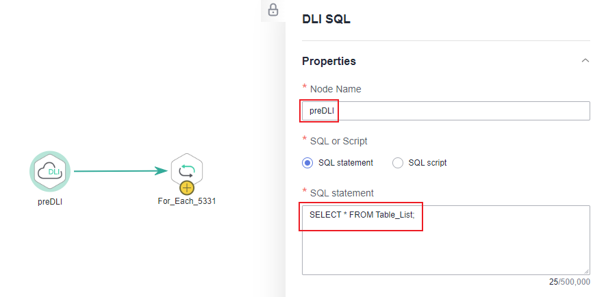

to compile the job shown in Figure 5. - Configure the properties of the DLI SQL node. Select SQL statement and and enter the following statement. The DLI SQL node reads data from the DLI table Table_List and uses it as the dataset.
SELECT * FROM Table_List;
Figure 6 DLI SQL node configuration

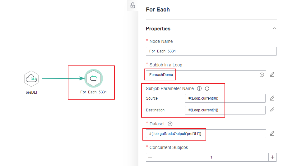

- Configure properties for the For Each node.
- Subjob in a Loop: Select ForeachDemo, which is the subjob that has been developed in step 2.
- Dataset: Enter the execution result of the select statement on the DLI SQL node. Use the #{Job.getNodeOutput('preDLI')} expression, where preDLI is the name of the previous node.
- Subjob Parameter Name: used to transfer data in the dataset to the subjob Source corresponds to the first column in the Table_List table of the dataset, and Destination corresponds to the second column. Therefore, enter EL expression #{Loop.current[0]} for Source and #{Loop.current[1]} for Destination.
Figure 7 Configuring properties for the For Each node

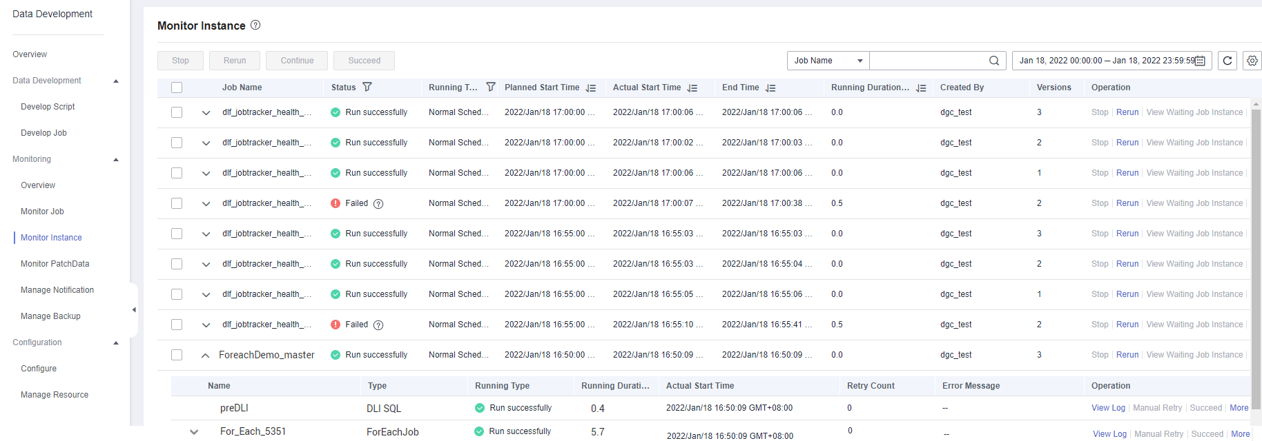

- Test the main job.
- Click Test above the canvas to test the main job. After the main job is executed, the subjob is automatically invoked through the For Each node and executed.
- In the navigation pane on the left, choose Monitor Instance to view the job execution status. After the job is successfully executed, you can view the subjob instances generated on the For Each node. Because the dataset contains six rows of data, six subjob instances are generated. Figure 8 Viewing job instances

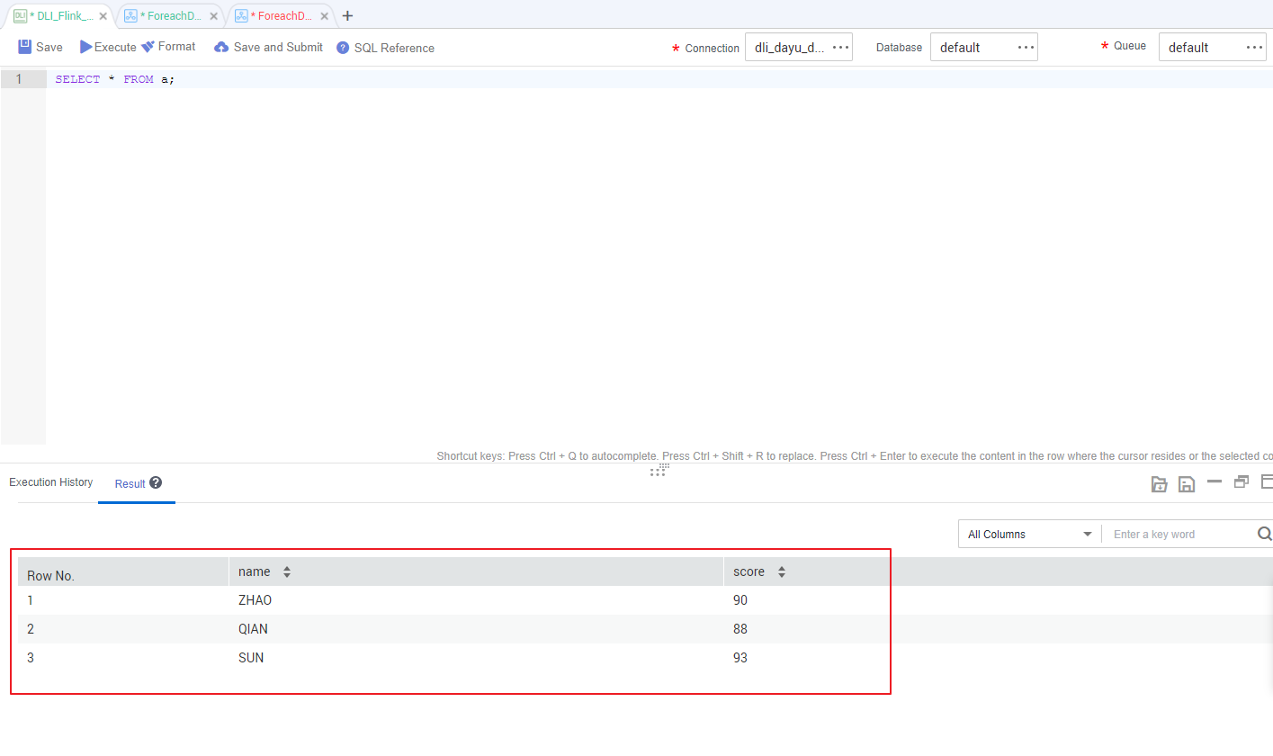

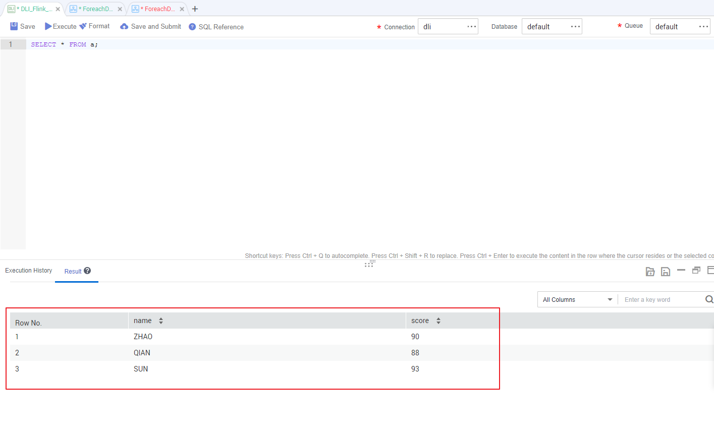

- Check whether the data has been inserted into the six DLI destination tables. You can create a DLI SQL script on the DataArts Factory page and run the following commands to import data into the table. You can also run the following SQL commands in the SQL editor on the DLI console.
/* Run the following command to query the data in a table (table a is used as an example): */ SELECT * FROM a;
Compare the obtained data with the data in Insert data into the source data table. The inserted data meets the expectation.
Figure 9 Destination table data
