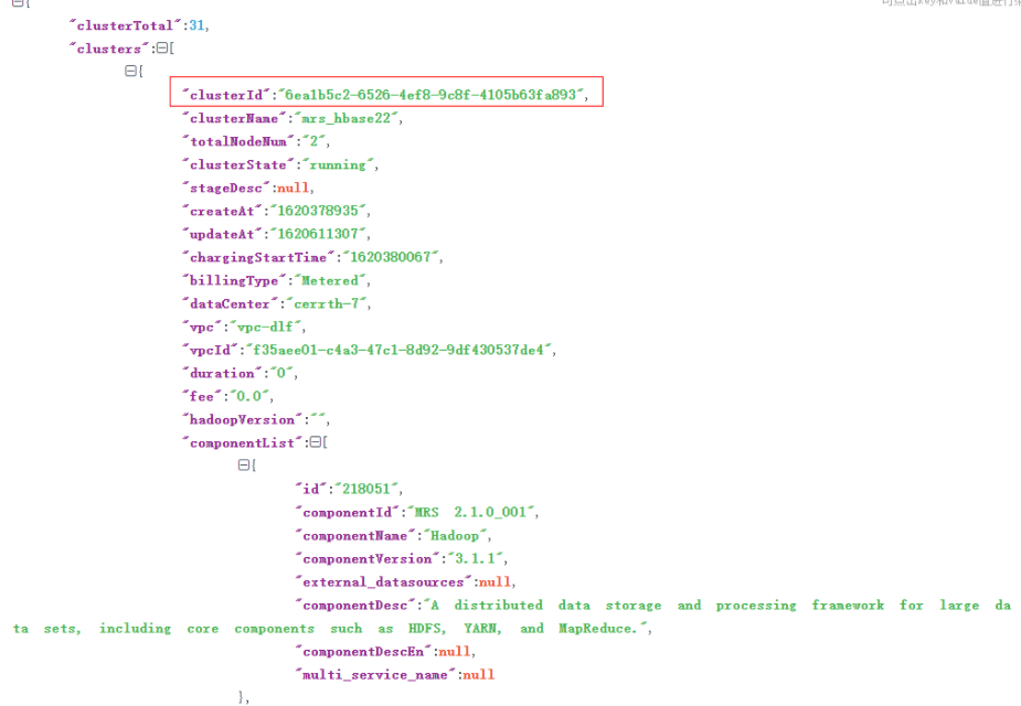

As shown in , the first Rest Client node invokes the API of MRS to query the cluster list. Figure 1 shows the JSON message body returned by the API.
- Scenario: The ID of the first cluster in the cluster list needs to be obtained and transferred to other nodes as a parameter.
- Key configurations: Set The response message body parses the transfer parameter of the first Rest Client to clusterId=clusters[0].clusterId. Other Rest Client nodes can reference the ID of the first cluster in ${clusterId} mode.

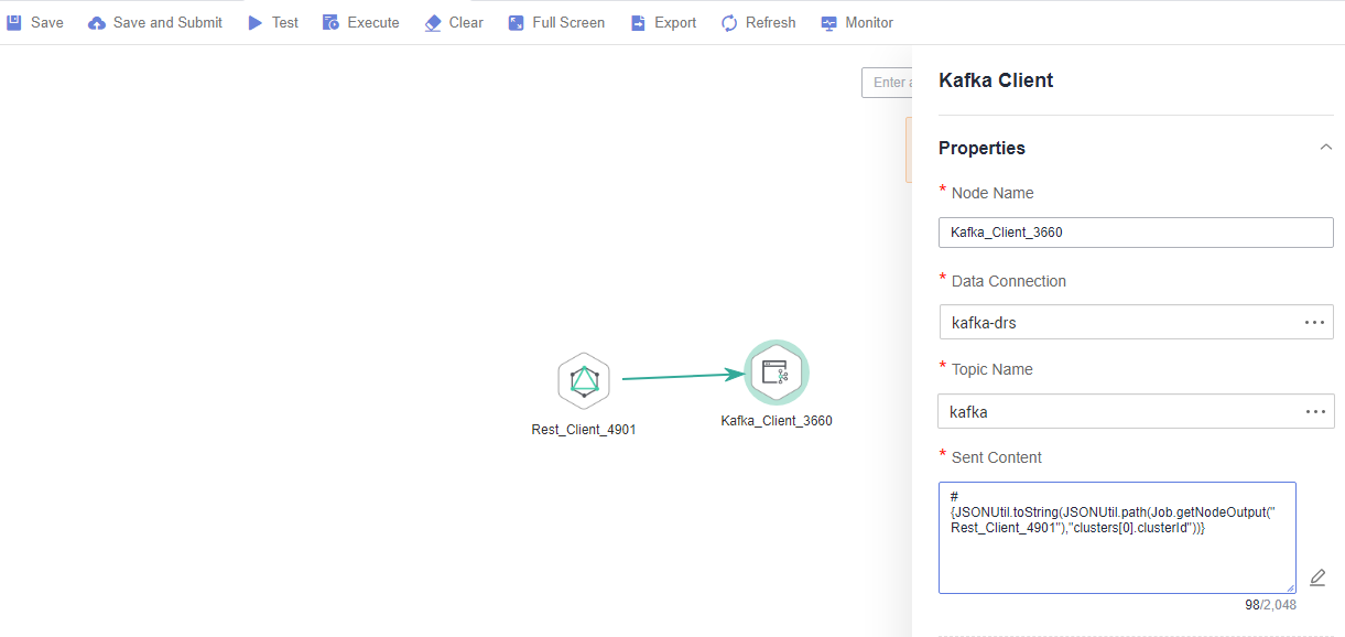

As shown in Figure 2, the Rest Client invokes the API of MRS to query the cluster list and then invokes the Kafka Client to send a message.
- Scenario: The Kafka Client sends a character string message. The message content is the ID of the first cluster in the cluster list.
- Key configurations: When you configure the Kafka Client, use the following EL expression to obtain a specific field in the message body returned by the REST API: #{JSONUtil.toString(JSONUtil.path(Job.getNodeOutput("Rest_Client_4901"),"clusters[0].clusterId"))}
