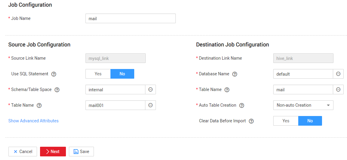

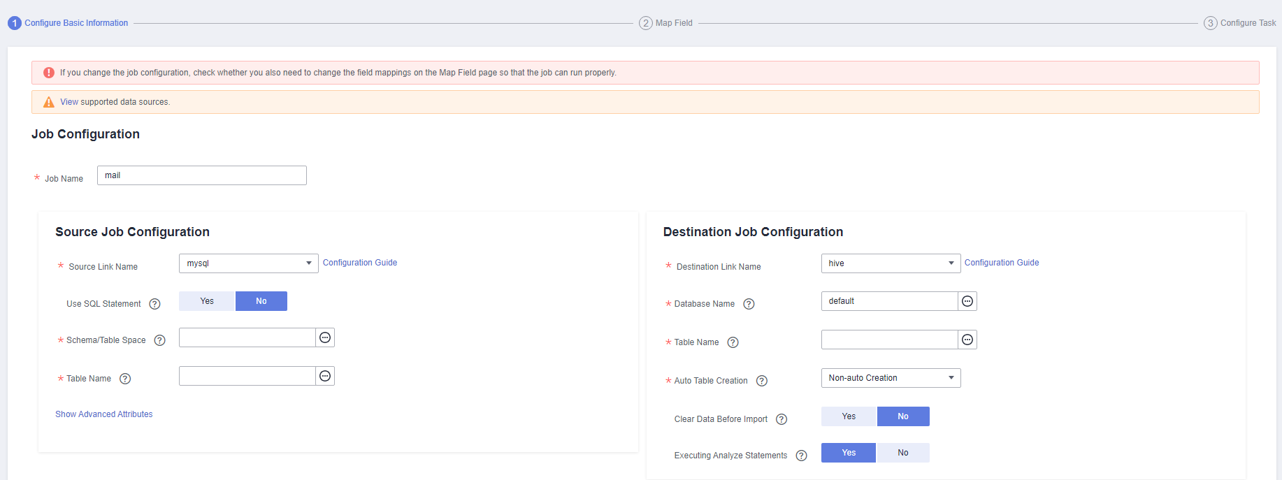

  2. Click the Table/File Migration tab and then Create Job to create a job for migrating data from the first MySQL subtable mail001 to the MRS Hive table mail.
    Figure 1 Creating a job
    Figure 2 Configuring basic information

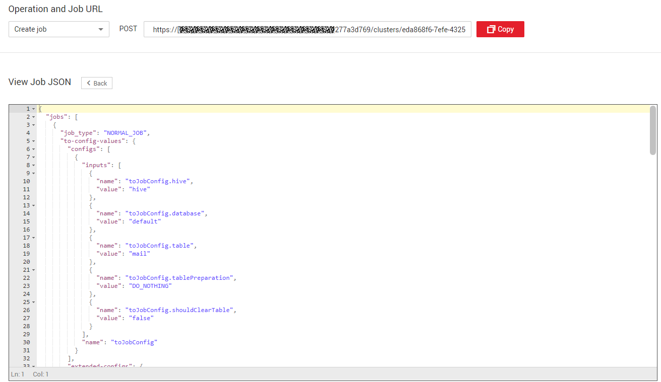

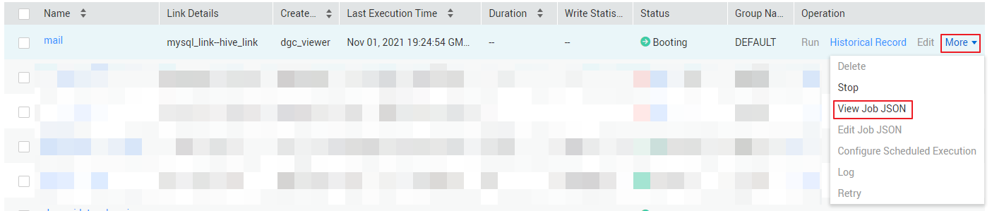

  3. After the sample job is created, view and copy the job JSON for subsequent configuration of data development jobs.
    Figure 3 Viewing job JSON
    Figure 4 Copying job parameters

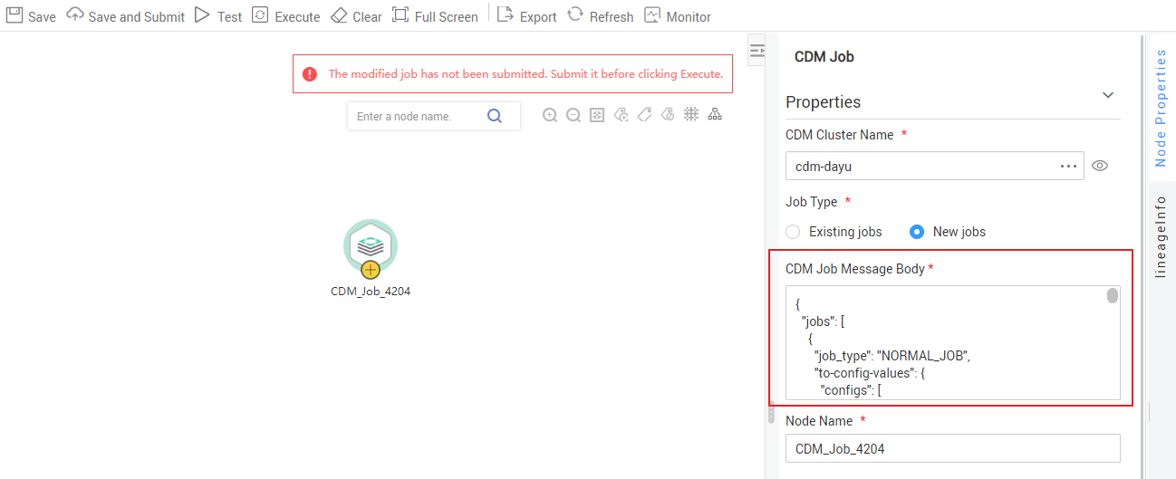

  2. Create a subjob named table, select the CDM node, select New jobs for Job Type in Properties, and copy and paste the JSON file in Step 2 to the CDM Job Message Body.

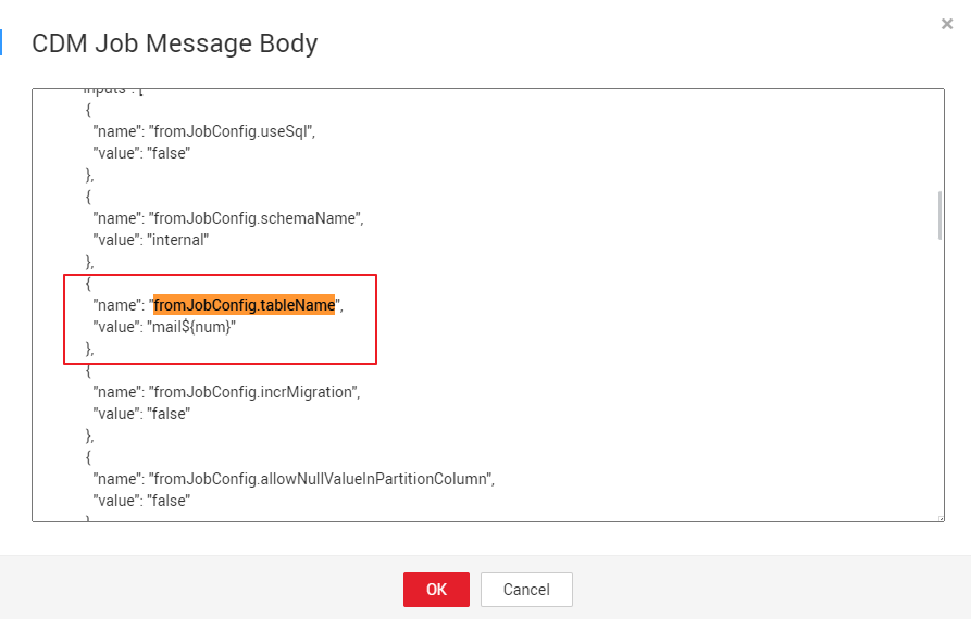

    1. Since there are three source tables mail001, mail002, and mail003, you need to set fromJobConfig.tableName to mail${num} in the JSON file of the job. The following figure shows the parameters for creating a main job.
      Figure 6 Editing JSON

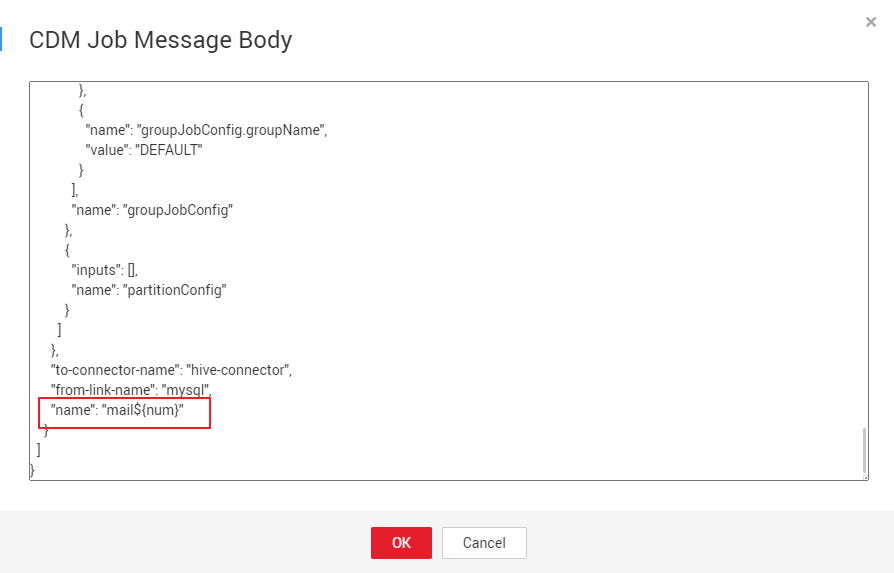

    2. The name of each data migration job must be unique. Therefore, you need to change the value of name in the JSON file to mail${num} to create multiple CDM jobs. The following figure shows the parameters for creating a main job.
      To create a sharding job, you can change the source link in the job JSON file to a variable that can be easily replaced.
      Figure 7 Editing JSON

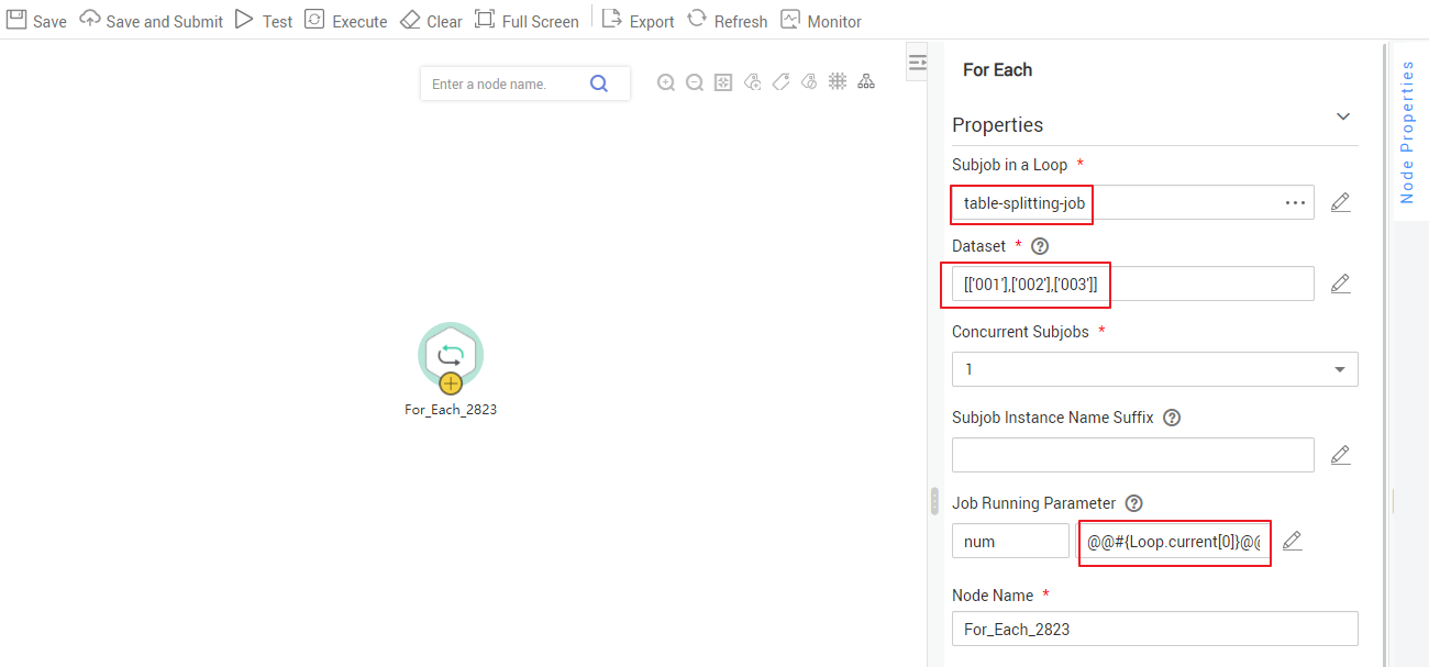

  5. Create the main job integration_management. Select the For Each node that executes the subjobs in a loop and transfers parameters 001, 002, and 003 to the subjobs to generate different table extraction tasks.
    The key configurations are as follows:
    • Subjob in a Loop: Select table.
    • Dataset: Enter [['001'],['002'],['003']].
    • Subjob Parameter Name: Enter @@#{Loop.current[0]}@@.
      Add @@ to the EL expression of the subjob parameter. If @@ is not added, dataset 001 will be identified as 1. As a result, the source table name does not exist.
    Figure 9 Configure key parameters
    Click Save and Submit to save the main job.

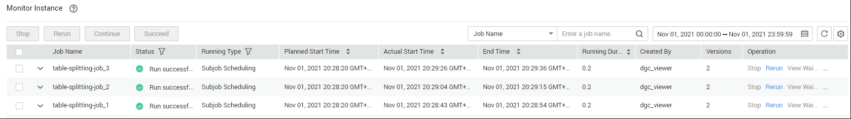

  6. After the main job and subjobs are created, test and run the main job to check whether it is successfully created. If the job is successfully executed, the CDM subjobs are successfully created and executed.
    Figure 10 Viewing the job creation status

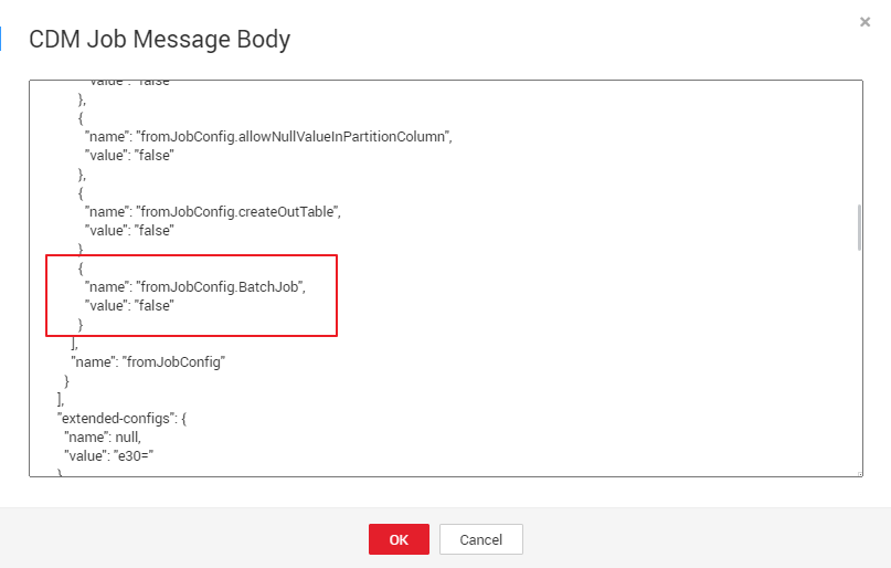

  • Some attributes, such as fromJobConfig.BatchJob, may not be supported in some CDM versions. If an error is reported during task creation, you need to delete the attribute from the request body. The following figure shows the parameters for creating a main job.
    Figure 11 Modifying an attribute
