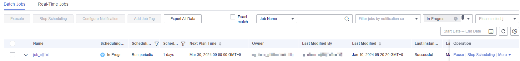

You can choose Monitor Job and click the Batch Job Monitoring tab to view the scheduling status, scheduling period, and start time of a batch job, and perform the operations listed in Table 1.
Figure 1 Monitoring batch jobs

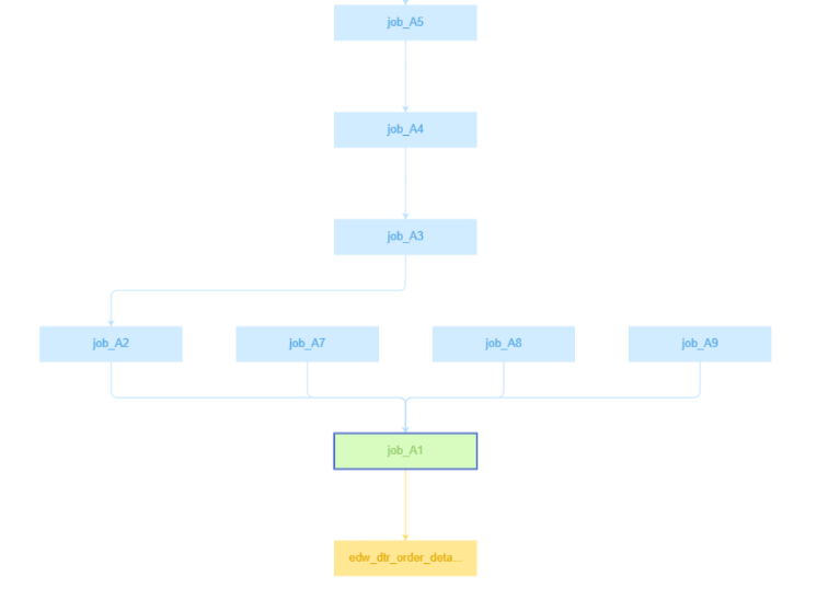

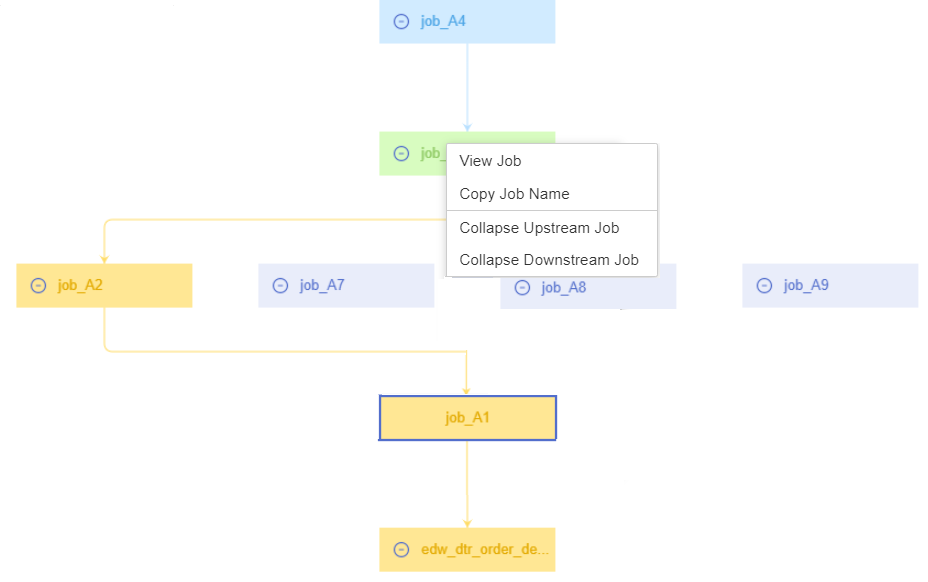

Viewing a job dependency graph
In the Operation column of a job, click More and select View Job Dependency Graph. For details, see Batch Job Monitoring: Viewing a Job Dependency Graph.

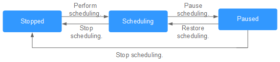

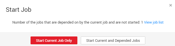

If a dependent job has been configured for a batch job, you can select either Start Current Job Only or Start Current and Depended Jobs when submitting the batch job. For details about how to configure dependent jobs, see Setting Up Scheduling for a Job Using the Batch Processing Mode.
If the job is on the baseline task link, the system automatically displays a dialog box indicating that the baseline is associated when the scheduling is paused or stopped.
If the job is on the baseline task link or is depended on by other jobs, the system automatically displays a dialog box when the scheduling is paused or stopped.
Figure 3 Starting a job

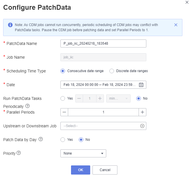

  5. In the Operation column of the job, choose More > Configure PatchData.
  6. Configure PatchData parameters based on Table 2.
    Figure 4 PatchData parameters
    Table 2 Parameters
    Parameter
    Description
    PatchData Name
    Name of the automatically generated PatchData task. The value can be modified.
    Job Name
    Name of the job that requires PatchData.
    Scheduling Time Type
    • Consecutive date range
      The PatchData time is a continuous date range.
    • Discrete date ranges
      The PatchData time consists of discrete date ranges.
    Date
    If Scheduling Time Type is set to Consecutive date range:
    Period of time when PatchData is required. If the date is later than the current time, the current time is displayed by default.
    NOTE:
    PatchData can be configured for a job multiple times. However, avoid configuring PatchData multiple times on the same date to prevent data duplication or disorder.
    If you select Patch data in reverse order of date, the patch data of each day is in positive sequence.
    NOTE:
    • This function is applicable when the data of each day is not coupled with each other.
    • The PatchData job will ignore the dependencies between the job instances created before this date.
    If Scheduling Time Type is set to Discrete date ranges:
    You also need to set the following PatchData parameters:
    You can click Add Date Range to add multiple discrete date ranges for PatchData. You must set at least one date range.
    You can click Delete to delete discrete date ranges.
    NOTE:
    DataArts Studio does not support concurrent running of PatchData instances and periodic job instances of underlying services (such as CDM and DLI). To prevent PatchData instances from affecting periodic job instances and avoid exceptions, ensure that they do not run at the same time.
    Run PatchData Tasks Periodically
    • Yes: PatchData jobs will be executed based on the configured period.
      The first value indicates a specific value.
      The second value indicates that data is patched based on a specified period, for example, hours, days, weeks, or months.
      NOTE:
      If you set a period, PatchData tasks will be scheduled based on that period. If the job is scheduled every few minutes, hours, or days, PatchData tasks will be scheduled based on the period you set. For example, if you want to patch data from 00:00 on Jan 1, 2023 to 00:00 on Feb 1, 2023 for an hourly job that starts at 01:00 every day, and set the PatchData period to two days, PatchData tasks will be scheduled at 00:00 on Jan 1, 2023, 00:00 on Jan 3, 2023, 00:00 on Jan 5, 2023, and so on. If the PatchData task scheduling period is in months and the first scheduling date falls on the last day of a month, PatchData tasks will be scheduled on the last day of each month.
    • No: PatchData jobs will not be executed periodically. Instead, the system executes PatchData jobs based on the existing rule.
    Cycle
    This parameter is required when Scheduling Time Type is set to Discrete date ranges.
    It specifies the PatchData cycle.
    You can click Viewing Scheduling Details to view the execution time of the task instances in the current time segment.
    NOTE:
    This parameter is required only when a job is scheduled by hour or minute and Scheduling Time Type is set to Discrete date ranges.
    Parallel Instances
    Number of instances to be executed at the same time. A maximum of five instances can be executed at the same time.
    If you select Yes for Patch Data by Day, Parallel Instances means the number of concurrent job instances on the same day.
    If you select No for Patch Data by Day, Parallel Instances means the number of concurrent job instances in the scheduling cycle.
    NOTE:
    Set this parameter based on the site requirements. For example, if a CDM job instance is used, data cannot be supplemented at the same time. The value of this parameter can only be set to 1.
    Upstream or Downstream Job
    Select the upstream and downstream jobs (jobs that depend on the current job) that require PatchData.
    The job dependency graph is displayed. For details about the operations on the job dependency graph, see Batch Job Monitoring: Viewing a Job Dependency Graph.
    NOTE:
    If you set Run PatchData Tasks Periodically to Yes, you can only select an upstream or downstream job with the same scheduling period as the job.
    Patch Data by Day
    If you select Yes, PatchData instances on the same day can be executed concurrently for a job, but those on different days cannot be executed concurrently. For example, a job instance scheduled at 5:00 and one scheduled at 6:00 can be executed concurrently, but a job instance scheduled on 1st of a month and one scheduled on 2nd of the month cannot be executed concurrently.
    Yes: Data is patched by day.
    No: Data is not patched by day.
    Stop Upon Failure
    This parameter is mandatory if Patch Data by Day is set to Yes.
    Yes: If a daily PatchData task fails, subsequent PatchData tasks stop immediately.
    No: If a daily PatchData task fails, subsequent PatchData tasks continue.
    NOTE:
    If data is patched by day and a PatchData task fails on a day, no PatchData task will be executed on the next day. This function is supported only by daily PatchData tasks, and not by hourly PatchData tasks.
    Priority
    Select a PatchData priority. You can set the priority of a workspace-level PatchData job in Default Configuration.
    NOTE:
    The priority of PatchData is higher than that of PatchData in the workspace.
    Currently, only the priorities of DLI SQL operators can be set.
    Ignore OBS Listening
    • Yes: OBS listening is ignored in PatchData scenarios.
    • No: The system listens to the OBS path in PatchData scenarios.
    Set Running Period
    Whether a running period can be set for the PatchData task.
    • Yes
      You can set the time period for running the PatchData task every day.
    • No
  7. Click OK. The system starts to perform PatchData and the PatchData Monitoring page is displayed.

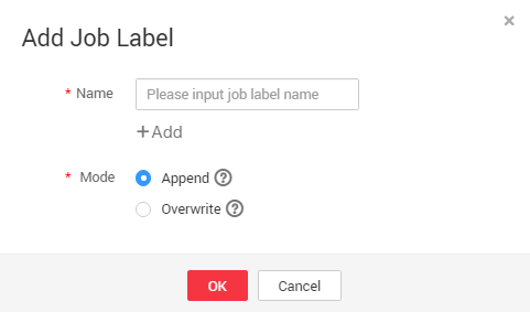

Batch Job Monitoring: Adding a Job Tag
Tags can be added to jobs to facilitate job instance filtering.
  1. Log in to the DataArts Studio console by following the instructions in Accessing the DataArts Studio Instance Console.
  2. On the DataArts Studio console, locate a workspace and click DataArts Factory.
  3. In the left navigation pane of DataArts Factory, choose Monitoring > Job Monitoring.
  4. Click the Batch Job Monitoring tab.
  5. In the Operation column of a job, choose More > Add Job Tag.
  6. In the Add Job Tag dialog box displayed, set the job tag parameters.
    Figure 5 Parameters for adding a job tag
  7. Click OK.

  6. On the displayed Job Dependency page, perform any of the following operations:
    • In the upper right corner, select Display complete dependency graphs, Display the current job and its upstream and downstream jobs, or Display the current job and its directly connected jobs.
    • In the search box in the upper right corner, you can enter the name of a node to search for the node. The node found will be highlighted.
    • Click Download to download the job dependency file.
    • Scroll your mouse wheel to zoom in or zoom out the dependency graph.
    • Drag the blank area to view the complete relationship graph.
    • When the cursor is hovered on a job node, the node is marked green, its upstream job is marked blue, and its downstream job is marked orange.
      Figure 6 Marking upstream and downstream job nodes of a node
    • Right-click a job node to view the job, copy the job name, and collapse upstream or downstream jobs.
      Figure 7 Job node operations
