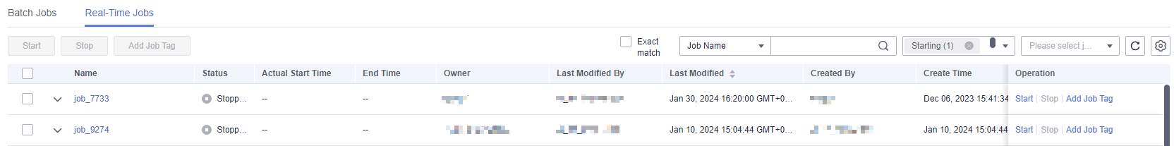

In the real-time processing mode, data is processed in real time, which is used in scenarios with high real-time performance. This type of job is a pipeline that consists of one or more nodes. You can configure scheduling policies for each node, and the tasks started by operators can keep running for an unlimited period of time. In this type of job, lines with arrows represent only service relationships, rather than task execution processes or data flows.
You can choose Monitor Job and click the Real-Time Job Monitoring tab to view the job status, start time, and end time, and perform the operations listed in Table 1.
![](https://support.huaweicloud.com/eu/usermanual-dataartsstudio/en-us_image_0000001174517213.png)
No. |
Operation |
Description |
1 |
Searching for a job based on the job name or owner |
2 |
Filtering jobs based on the job status or job label |
3 |
Perform operations on jobs in a batch |
Select multiple jobs and perform operations on them. |
4 |
Viewing job instance status |
Click job in front of the |
5 |
Job status-related operations |
In the Operation column of the job, you can start, pause, recover, and stop job scheduling. |
6 |
Adding a job label |
In the Operation column of a job, choose . |
7 |
Viewing node information of a job |
Click a job name. On the displayed page, click a node to view its associated job/scripts and monitoring information.
NOTE:
If event-driven scheduling is configured for a node in the job, the subjob monitoring page is displayed when you click the node. |
8 |
Disabling and restoring a node |
Click a job name. On the displayed page, right-click a node and select Disable. After the node is disabled, you can right-click it and select Restore to restore it on another location. For details, see Real-Time Job Monitoring: Disabling and Restoring a Node. |
9 |
Viewing the boot log |
Click a job name. On the displayed page, right-click a node and select View Run Log to view logs of the node. |
10 |
Configuring scheduling |
Click a job name. On the displayed page, right-click the node where event-driven scheduling is configured and select Configure Scheduling to view and modify the scheduling information about the node. For details, see Real-Time Job Monitoring: Configuring Scheduling for a Node Where Event-driven Scheduling Is Configured. |
11 |
Monitoring subjobs |
Click a job name. On the displayed page, click the node where event-driven scheduling is configured to go to the subjob monitoring page. For details, see Real-Time Job Monitoring: Monitoring Subjobs. |
12 |
Clearing stream messages |
Click a job name. On the displayed page, right-click the node where event-driven scheduling is configured and select Clear Stream Message. |

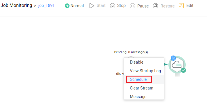

If event-driven scheduling is configured for a node in a real-time job, right-click the node on the job monitoring details page and choose Configure Scheduling from the shortcut menu to view and modify the scheduling information about the node.
- Log in to the DataArts Studio console. Locate an instance and click Access. On the displayed page, locate a workspace and click DataArts Factory.
- In the left navigation pane of DataArts Factory, choose .
- On the Real-Time Job Monitoring tab page, click a job name.
- On the displayed page, right-click the node where event-driven scheduling is configured, select Configure Scheduling, and configure the parameters shown in Table 3.
