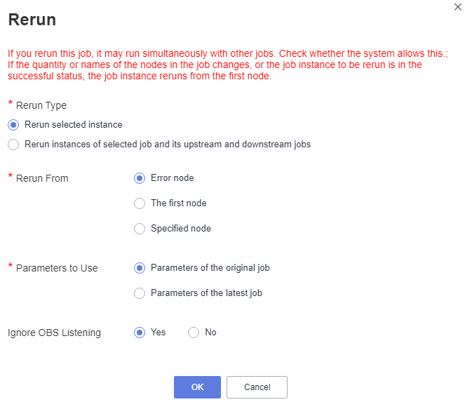

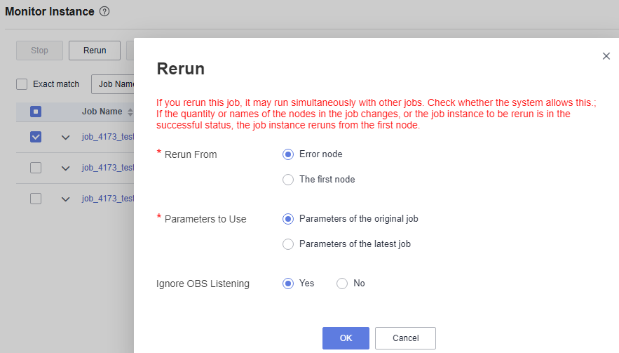

- Locate a job and click Rerun in the Operation column to rerun a job instance. Alternatively, select the check boxes to the left of job names and click Rerun above the job list to rerun multiple job instances.
Figure 1 Rerunning a job instanceFigure 2 Rerunning job instances
When rerunning multiple job instances, you only need to set Rerun From, Parameters to Use, and Ignore OBS Listening.
Table 3 Parameters for rerunning a job Parameter
Description
Rerun Type
Type of the instance that you want to rerun.
- Rerun selected instance
- Rerun instances of selected job and its upstream and downstream jobs

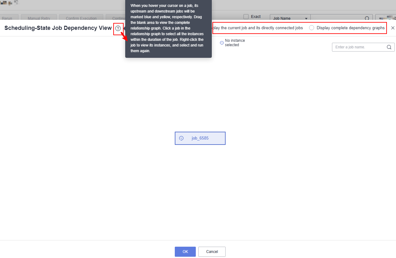

You can select Display the current job and its directly connected jobs or Display complete dependency graphs in the Scheduling-State Job Dependency View dialog box.
The job dependency view is displayed. You can enter a job name to query the job dependency.
Figure 3 Job Dependency pageSelect the job to rerun and its upstream and downstream jobs. You can select multiple jobs at a time.
NOTE:If you hover over the question mark on the right of Scheduling-State Job Dependency View, the following information is displayed:
- When you hover your cursor on a job, its upstream and downstream jobs will be marked blue and yellow, respectively.
- Drag the blank area to view the complete relationship graph.

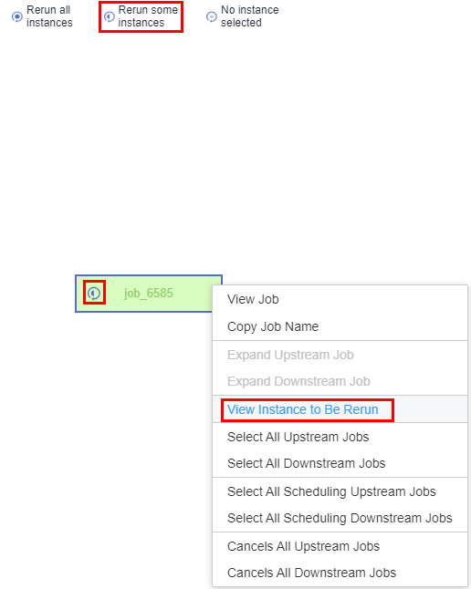

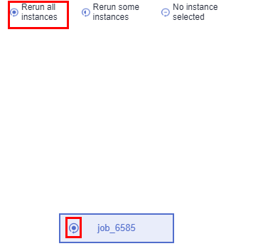

- Click a job in the relationship graph to select all the instances within the duration of the job.
Figure 4 Rerunning all instances
- Right-click the job to view its instances, and select and run them again.
Figure 5 Rerunning some instances

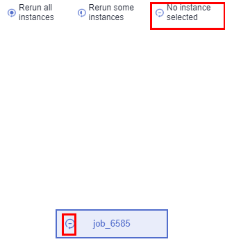

- If no job instance is selected, No instance selected is displayed.
Figure 6 No instance selected

Rerun From
Start position from which the job instance reruns.
- Error node: When a job instance fails to be run, it reruns since the error node of the job instance.
- The first node: When a job instance fails to be run, it reruns since the first node of the job instance.
- Specified node: When a job instance fails to run, it reruns since the node specified in the job instance. This option is available only if Rerun Type is set to Rerun selected instance.
NOTE:A job instance reruns from its first node if either of the following cases occurs:
- The quantity or name of a node in the job changes.
- The job instance has been successfully run.
Parameters to Use
- Parameters of the original job
- Parameters of the latest job
Concurrent Instances
This parameter is required only when Rerun Type is set to Rerun instances of selected job and its upstream and downstream jobs.
It indicates the number of job instances that can be concurrently processed. The value cannot be less than 1. The default value is 1.
The default value is Yes.
- Yes: The system does not listen to the OBS path when rerunning the job instance.
- No: The system listens to the OBS path when rerunning the job instance.

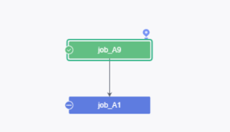

Figure 7 DAG
By default, the DAG displays the current job instance and its upstream and downstream job instances. It supports the following operations:

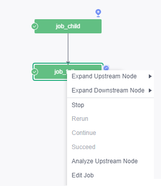

- Right-click a job instance to expand its upstream and downstream job instances. You can stop, rerun, continue to execute instances, forcibly make instances succeed, analyze the upstream node, and edit the job.
Figure 9 Performing operations on job instances

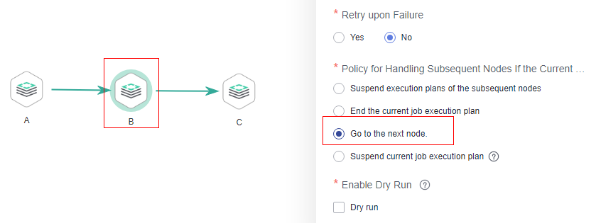

Failure ignored |
As shown in the following figure, a failure handling policy is configured to skip node B and continue to execute node C if node B fails. When the job is executed successfully, the job instance is in Failure ignored state.
Figure 10 Failure handling policy – Go to the next node

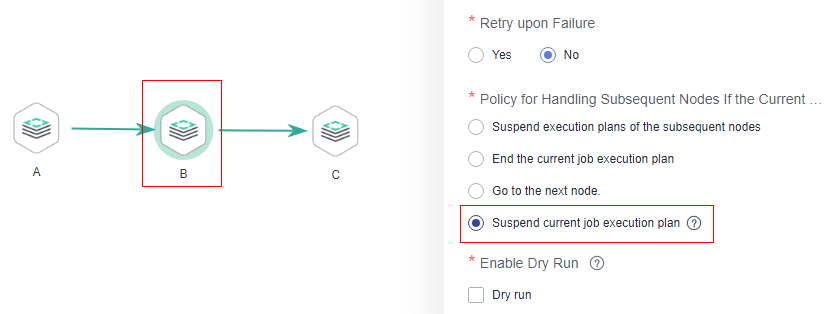

Abnormal |
There are few scenarios where this status is displayed. As shown in the following figure, a failure handling policy is configured to suspend the job instance immediately without continuing to execute node C. In this case, the job instance is in Abnormal state.
Figure 11 Failure handling policy – Suspend current job execution plan
