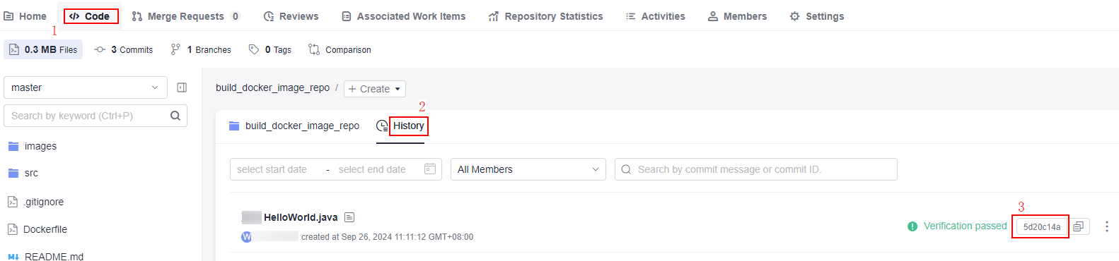

You can specify a source version with a code repository tag or commit ID. Besides, you can enable auto update of submodules and Git Large File Storage (LFS) for your build.

| commit | String | Optional. If needed, you can enter a commit ID to indicate the specific version of the source code to be pulled for your build. You can also use ${commitId} to reference this parameter. |
| tag | String | Optional. If needed, you can enter a tag to indicate the specific version of the source code to be pulled for your build. You can also use ${tag} to reference this parameter. If you provide both the commit ID and tag, the build using the commit ID will be run first. |
