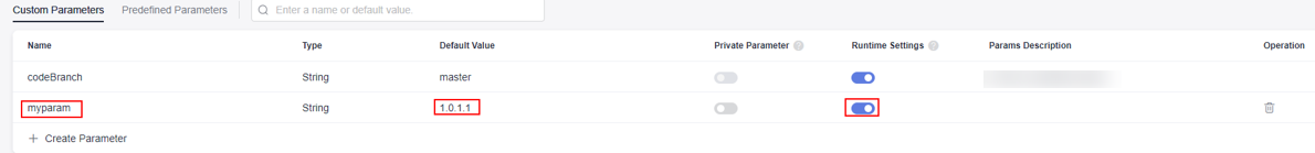

Adding Custom Parameters
On the page for configuring the build task, click the Parameters tab. On the displayed page, click Create Parameter, and set parameters according to Table 2.
        Name  |
        Type  |
        Default Value  |
        Private Parameter  |
        Runtime Settings  |
        Params Description  |
        Name of a custom parameter. The value can contain a maximum of 128 characters, including letters, digits, and underscores (_).
         NOTE:
        String  |
        Default value of the custom parameter. Max. 8,192 characters.  |
        Specify whether the parameter is private or not. If the parameter is private, the system encrypts the input parameter for storage and only decrypts the parameter for usage. Private parameters are not displayed in run logs.  |
        Specify whether to set this parameter when running the build task. If Runtime Settings is enabled, the parameter value can be changed when you click   |
        Enter additional information to describe the parameter. Max. 1,024 characters.  |
        Enumeration  |
        In the displayed dialog box, enter enumerated values in the Value text box. Each parameter value must end with a semicolon (;). Max. 8,192 characters. Once you have set the enumerated values, select a default value for the parameter from the Default Value drop-down list box.  |
        Auto Increment  |

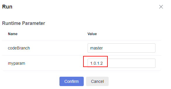

 - In the displayed dialog box, change the value of myparam to 1.0.1.2 and click OK. Wait until the build task is completed.

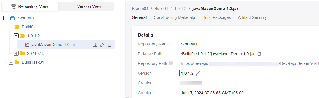

     - Go to the release repo and find the resulting build package. The version number is the modified value of myparam.
