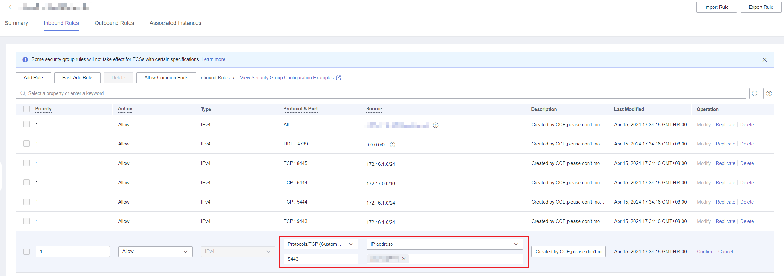

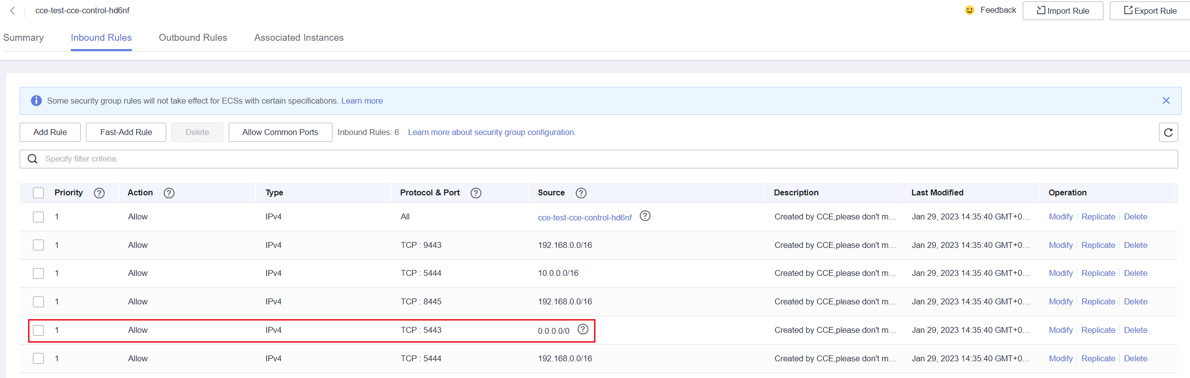

  5. On the page displayed, locate the row that contains port 5443 and click Modify in the Operation column to modify its inbound rules.
  6. Change the source IP address that can be accessed as required. For example, if the IP address used by the client to access the API Server is 100.*.*.*, you can add an inbound rule for port 5443 and set the source IP address to 100.*.*.*.
    In addition to the client IP address, the port must allow traffic from and to the CIDR blocks of the VPC and container to ensure that the API Server can be accessed from the cluster.
